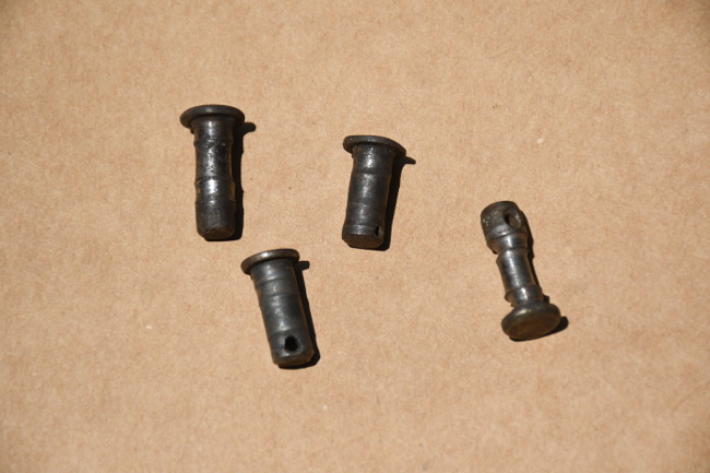

One possible reason for the change is the clevis pins. The one on the right of this image would "cam" and change the engagement point of the clutch. Granted these are extremes, all taken from customers' cars where "the clutch is going bad" according to them or other shops.
