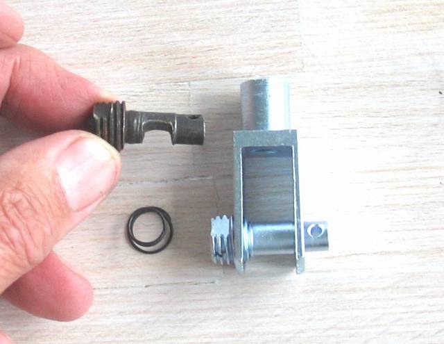

Before doing a huge job as suggested above, check the link on the front end of the push-rod coming out the front end of the master cylinder for the clutch. All you have to do is study the situation and if I'm correct, you'll need to remove the wiper motor and carefully lay it to one side.
My cross link looked like this in 2004 when I heard this "clicking and clacking" while in Virgina wathching the TR races at VIR. It took me about 45 minutes to change for the spare that I had with me.

Yes, rule out the simple stuff first. Double check the clevis pin on the clutch master cylinder push rod. Mine became grooved and starting making a metalic clicking which could be felt in the clutch pedal. But, no doubt, the sound was coming from behind the firewall up by the master cylinders. Replaced it with a nice hard, stainless steel clevis pin. Cost: $1.25

I would think it would be better to have a standard (softer?) clevis pin so it wears versus having the hole in the pedal wear?

Scott has a good point. After I changed the cross-link pin and yoke, I stiil (on occasion) could hear the "click" so the next time I had things apart, I looked at the hole on the top end of the clutch pedal. The hole had become oval so I removed the entire pedal assembly under the dashboard and MIG welded the oval hole smaller and re-drilled the hole for the cross-pin round again. Since then it's been smooth and quiet.

The clicking on my clutch (see photo above) would go away from time to time as the cross pin would rotate. But whenever there was a clicking sound, it was hitting on the full diameter and moving as it should, then it would fall into the worn area with a "click". I could feel something in the pedal arm too.
