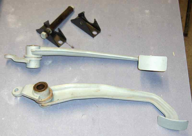

Here's a shot of what my clutch slave looked like, after being stored "wet" for about 25 years:

As always, Randall is probably correct. I'd start with flushing the hydrolics and see if that doesn't fix it. Aside from the return spring at the transmission cross shaft, there should also be a spring at the pedal. The shaft that goes thru the brake and clutch pedals were so corroded on mine, that it was very difficult to take apart. And also that boxed in area on mine was full of sand. Once it gets cleaned and a little grease, it will move much more freely.
