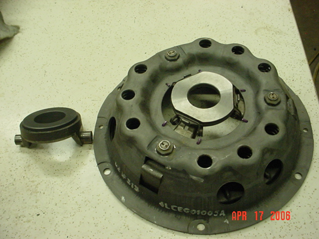

Healeys & a few other cars use a carbon face throwout bearing. It has no actual bearings in it. See attached pic. The small part, throwout bearing, only has a carbon face that bears on the metal ring on the clutch release levers, or diaphram on later models.
Every time that the clutch pedal is depressed, a small amount of carbon wears off. The linkage should also be adjusted with enough free play to prevent bearing contact with the clutch when the pedal is out. The less time you push on the clutch pedal, the longer the carbon bearing will last.
D

Transmission in neutral, foot off the pedal, for all cars. Not only for the sake of the bearing, but also the disc lining wears only when disengaged. AND, the forward thrust you are exerting on the crankshaft thrust washers is extreme. Modern cars with "safety" switches are forcing you to push the crank forward before starting (and oil pressure).

Ball bearing release bearings are available aftermarket for some models. They are sometimes used with ultra stiff competition clutches. Pretty expensive though. The owners of some marques seem to be on an endless search for a better ball bearing release bearing, so just converting is not a sure fix either. The carbon type will last 90,000 miles or more if it is not "abused" & if it is adjusted to not be engaged when the pedal is not operated.
As Peter said, the crankshaft end thrust bearing will thank you also. Ever notice the engine idle slowing a bit when the clutch pedal is depressed. This is due to the friction load on the throwout bearing & the crankshaft thrust washers.
