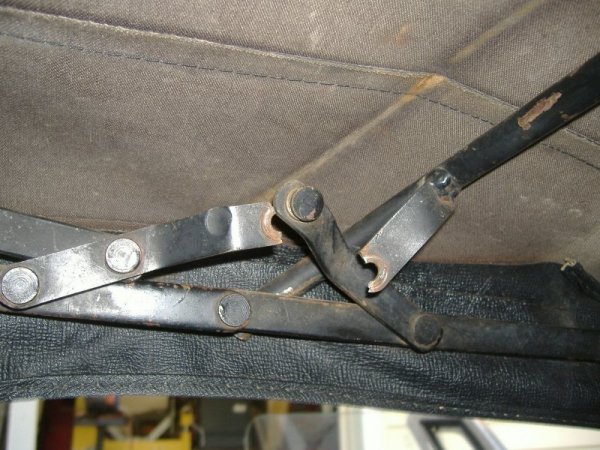

bill_young
M
mightymidget
bill_young said:
This is the typical break point for that type of frame. I've repaired two of them over the years using the method shown in the photos. It's easy if you can weld.
https://www.flickr.com/photos/28194759@N08/sets/72157605953004040/
Yep that my exact problem, felt like it might be repairable, when I get a new mig with gas I might just fix it. any ideas why they all break here, will the other side do the same?
thanks for shared repair
