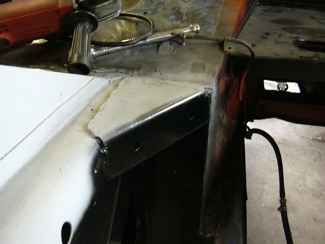

mgblue79
mgblue79
Member
Pics
Ok, the attachment shows the part I have been wondering about. The talk about cutting the passenger footwell has me a bit confused. I was of the understanding that the piece in the photo is what gets in the way.???
