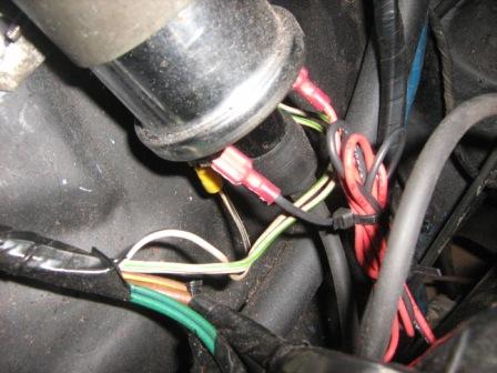

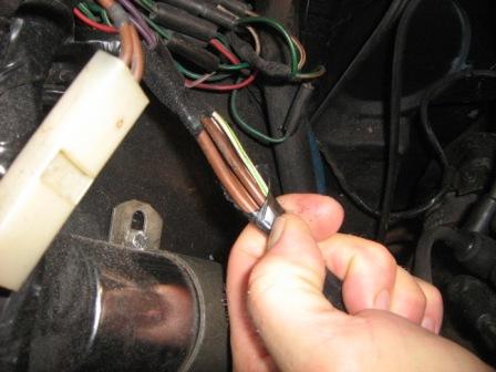

OK, Naomi....having just fought this battle with our 1980 B...
WHen we got it the ignition had been bypassed and a push button start added...so....
we added an electronic ignition and new ignition switch. We pulled the entire harness because we thought it was the wrong one for our car...it just needed some tweaking.
The first picture is the solenoid...the red and black on the front are from the coil.
The black and white and green and white are from the starter.
We cut and taped off those other wires because they were no longer needed with the electronic igntion.
I don't know if ours is "right" for an 80 B, but when I trun the key it fires up. We played heck getting any pictures that resembled what we had underr our hood.
Maybe these will help

N
Naomi
Thank you so much for the pictures and message! It is odd how the 80MGB is wired and I do hope others will pipe in and we can see the different ways the 80 model are wired and if anyone has a period correct one. Thanks again :smile:

terriphill
Re: Question about ignition wiring unique to 1980
Naomi,
After looking at that piece, I know that ours doesn't have one. so, I guess the pics aren't much help. It was such a mess when we got it that we pulled the harness and dash and steering column wiring and reworked it all by tracing wires with a wiring diagram, I guess I got lucky cause it may not be right, but it runs great!
