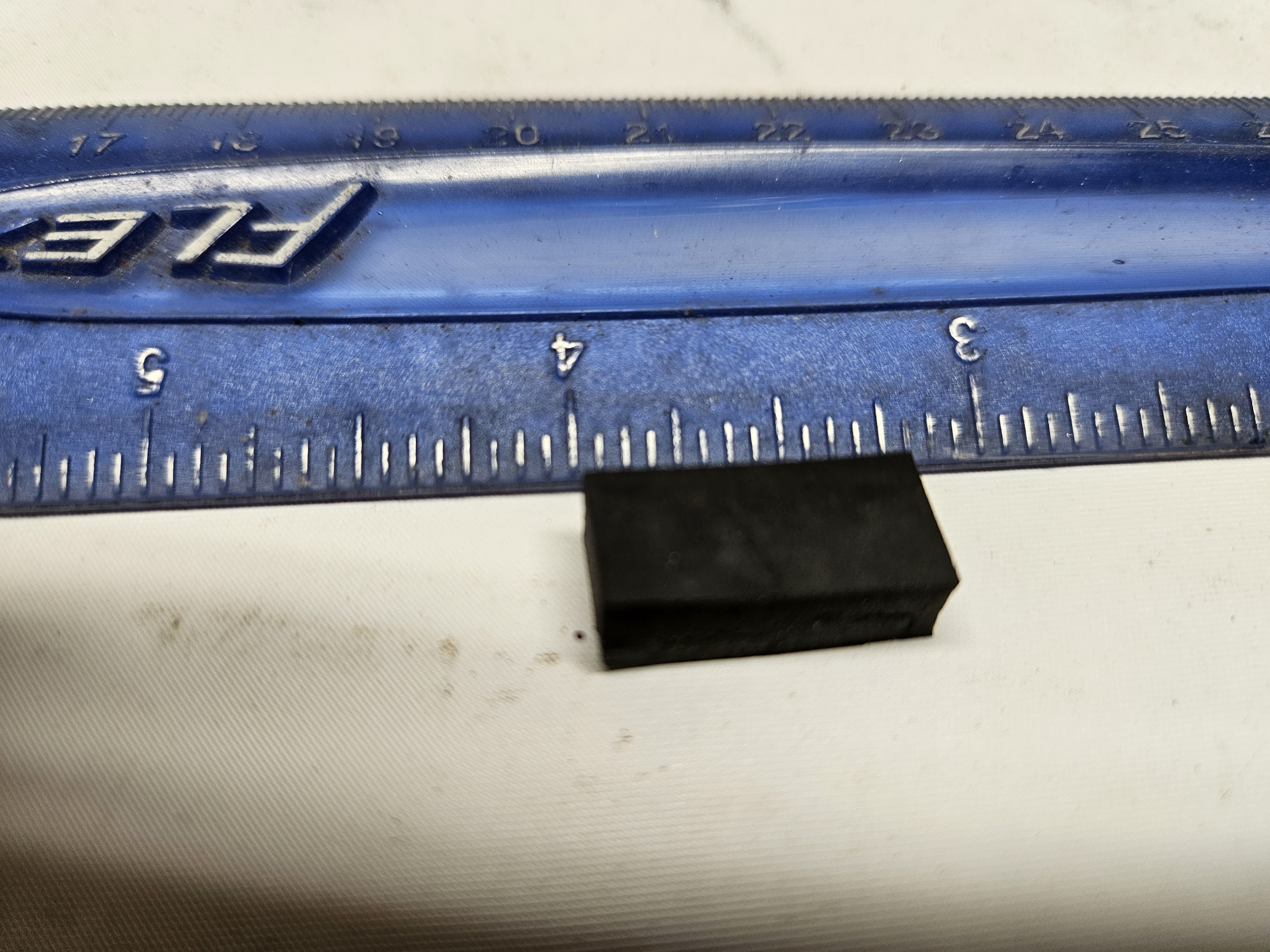

Hi Folks. Back again. Getting there.. seats and windshield and I'll be ready for a test drive. After 7 1/2 years. Oh yeah, my question.. on my tr3a.. post 60000 windshield there were rubber cushions, though only one was still attached, presumably to keep the glass off the through tenax fasteners in the upper sections of my windshield. How many should there be? The more, the merrier? And should they used in the lower section of the frame? I really only want to do this once. I gotta tell you this thing is staring me down. Also there is a hole drilled centered in the lower section of the frame. What is this for?

Unless you are a very experienced glass man with access to old school bits&bobs , you will have to urethane
the glass into the frame. Gorilla tape 8 spots (3 top,3 bottom ,2 side) to act as spacers. Should fit the frame firmly
but not need to be pounded into place. When the frame is assembled, pump the windshield fast setting urethane
into the void in the frame.Be as careful as you can, wear disposable gloves, it will make a serious mess. Allow to set
overnight.Clean up the glass with a sharp razor blade, use 0000 steel wool on the chrome.
The original install used glass tape and is hard to find in the correct thickness.The frame was then pounded onto the glass
sometimes breaking it. Cheap then But not now.....

Thanks for the replies guys. I also will be using the glazing rubber from TRF. 1.. are the rubber pieces in the photo what you are calling spots? As a spacer of sorts.

The glazing strip is one piece and wraps around the glass and is then inserted into the frame. There may be some small spacers inside the top part of the frame . These are to prevent the glass from getting to far up in the frame. The convertible top studs need that room.
