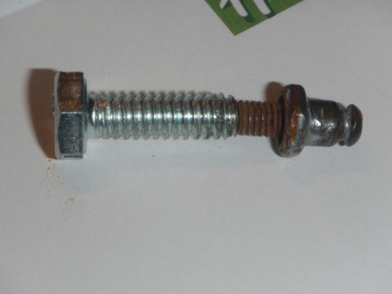

How thick is the screen frame where the studs screw in.
Was thinking if there is enough material to tap it 1/4 28 then drill and tap a 1/4 28 bolt 2BA and cut the bolt into short bits. screw and lock tite the studs into the new piece.
I did this in my drill press using a 4mm drill bit and a 2BA tap. I used a 1/4 20 as I did not want to mess up a TR bolt.
David
