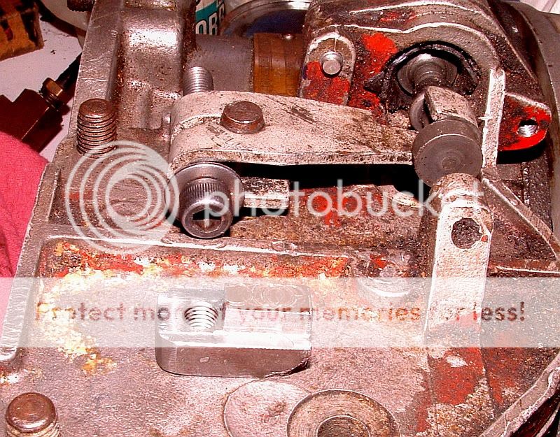

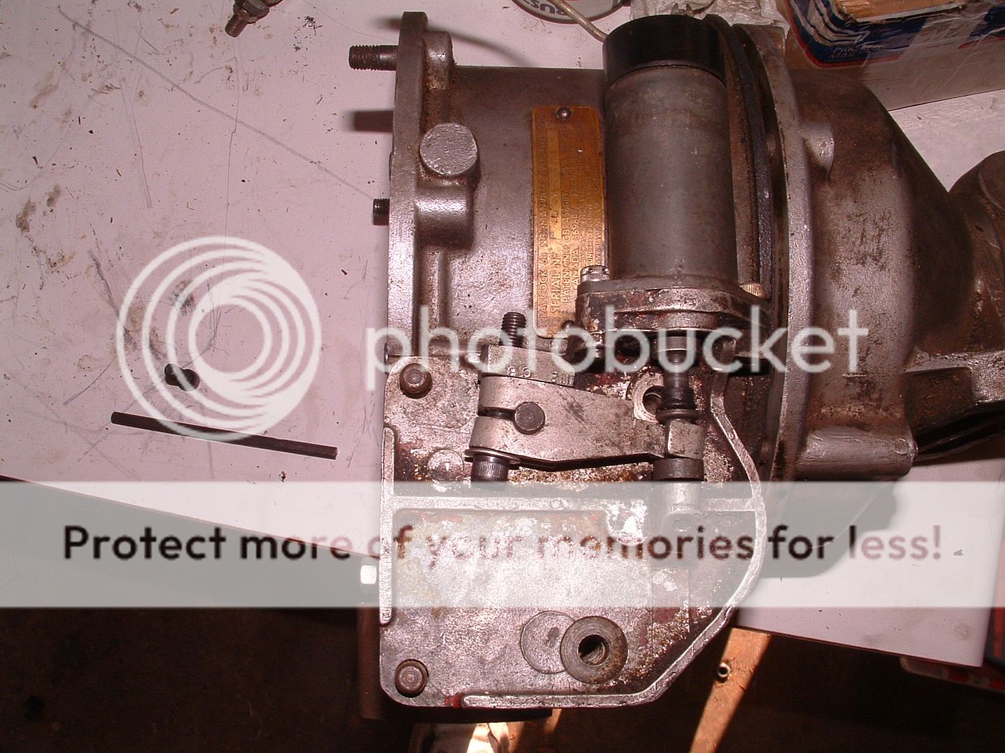

Not sure I follow about the pin going into the bottom hole. The solenoid lever is supposed to be somewhat loose on the solenoid shaft, but has to be clamped very firmly on the operating shaft that runs through the body of the OD. I got frustrated with mine slipping in service, so I made a custom nut and used a high tensile socket head screw for the clamp. Now I can get it plenty tight, even with the unit in the car and the tunnel installed.
