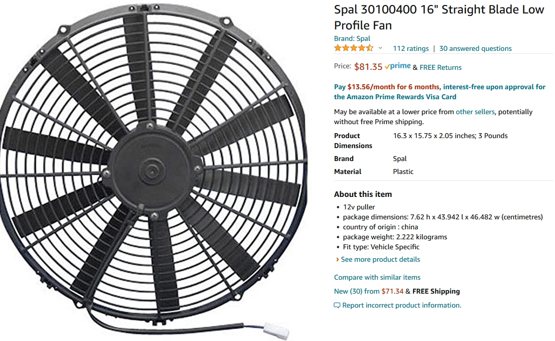

Has anyone found a low-profile electric “puller” fan for between the radiator and water pump (without the metal fan).
Also, an aftermarket shroud for the engine side of radiator?
I have an AC condenser in front of my radiator and a pusher fan does not efficiently push air through the condenser and radiator. A puller is much more effective.
Thanks
Patrick67BJ8
Patrick67BJ8
This is the narrowest I could find: > Maradyne 14in Electric Fan <
I found this. Wizard has a similar setup, but is a pusher. I’m going to contact both of these suppliers.

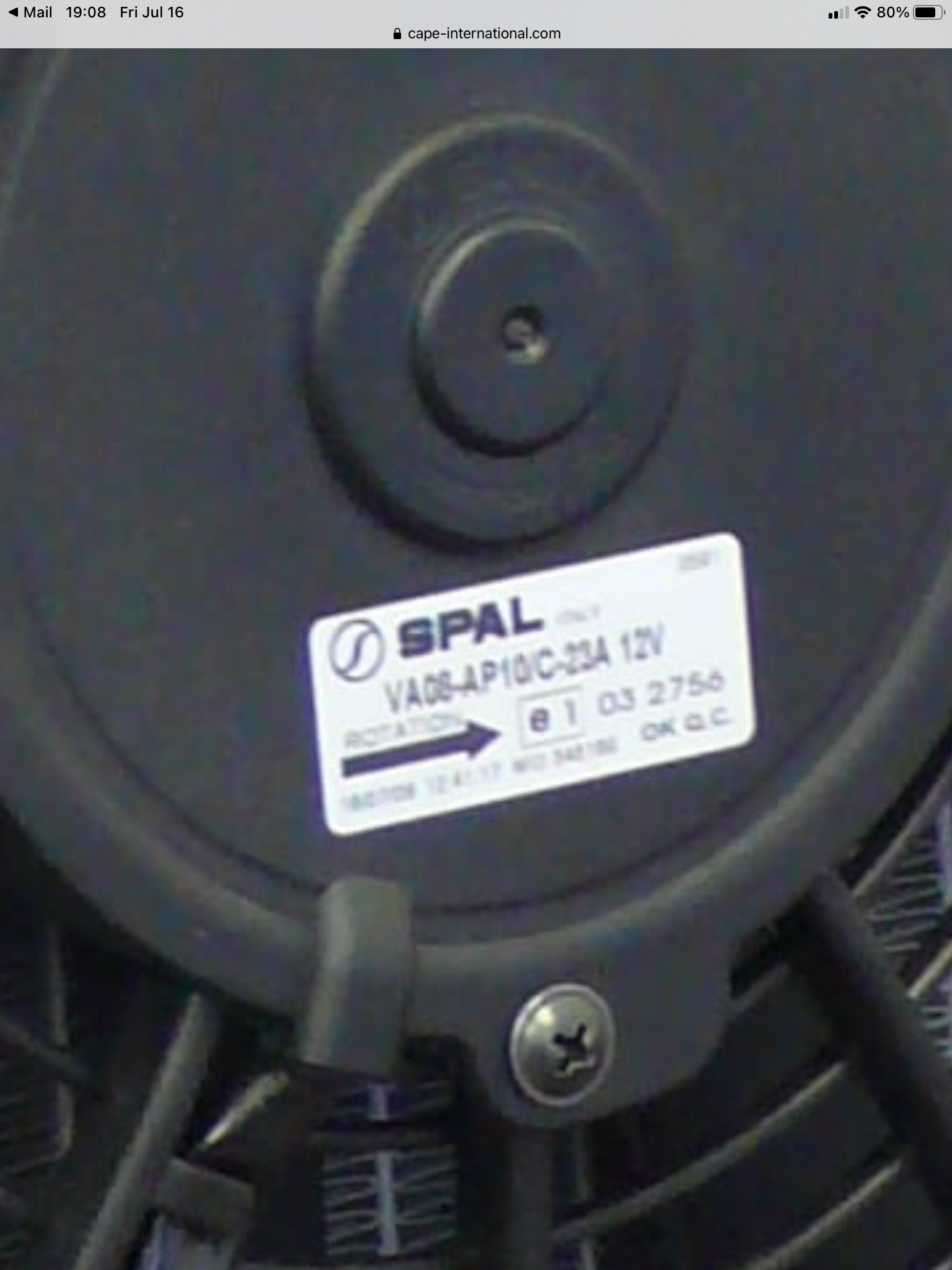

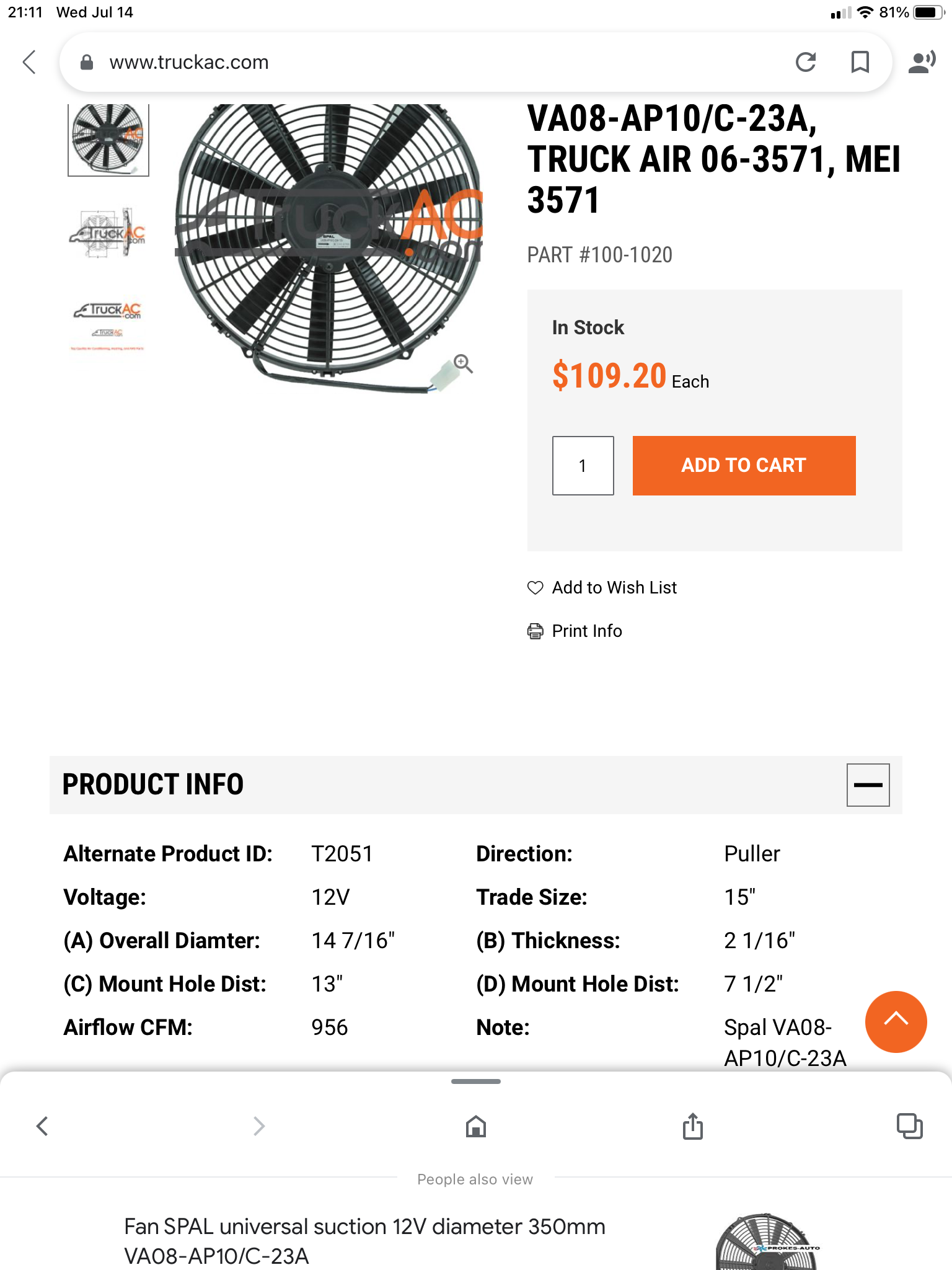

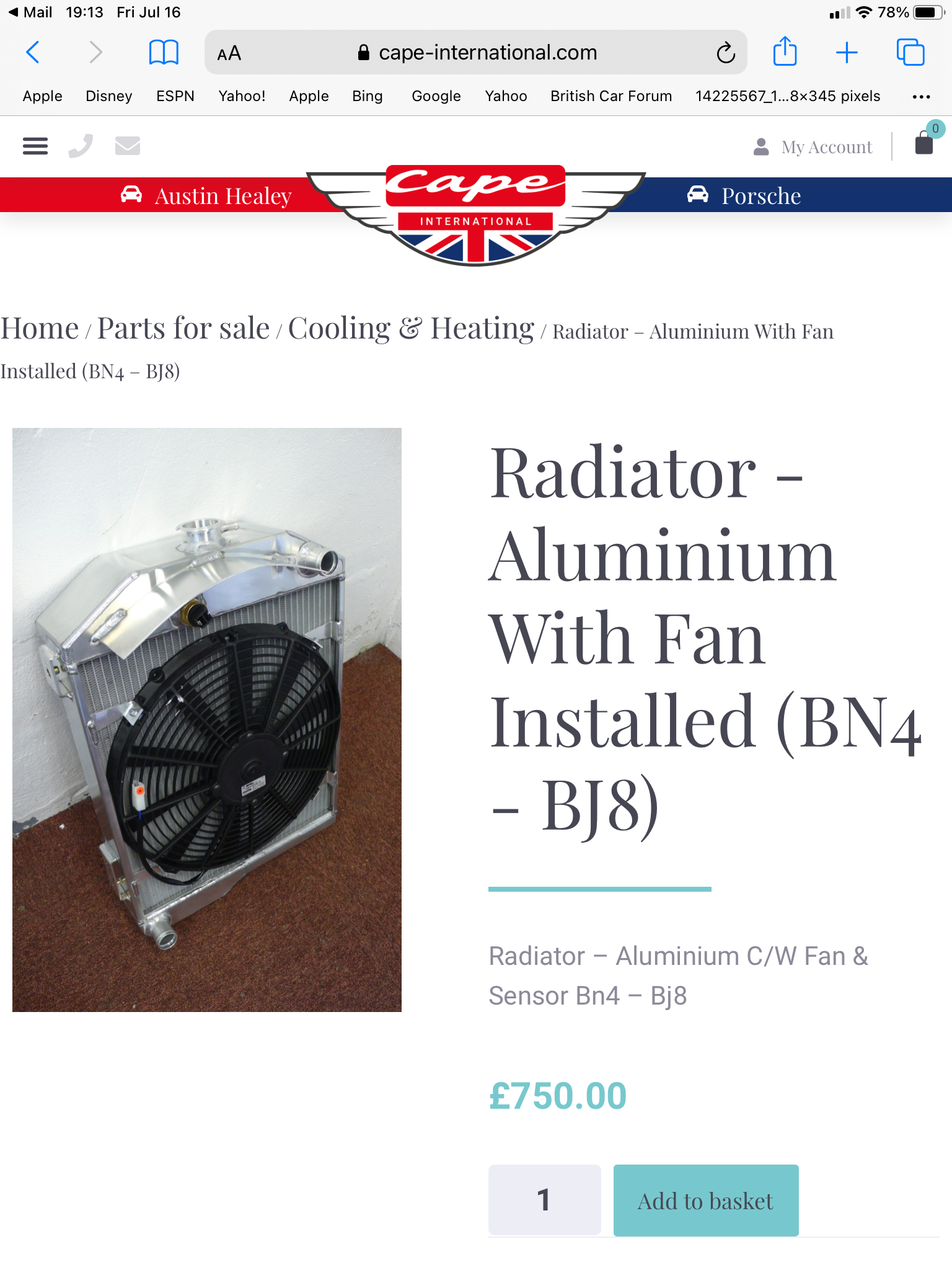

Cape has one with a radiator that is a puller. I assume that it fits since it’s for the six-cylinder Healeys. One thing is missing is a shroud, but may not be required. The fan is 2 1/16” thick.

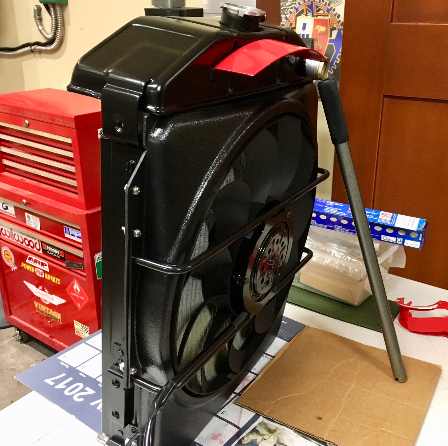

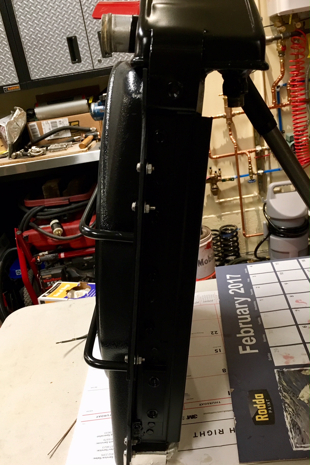

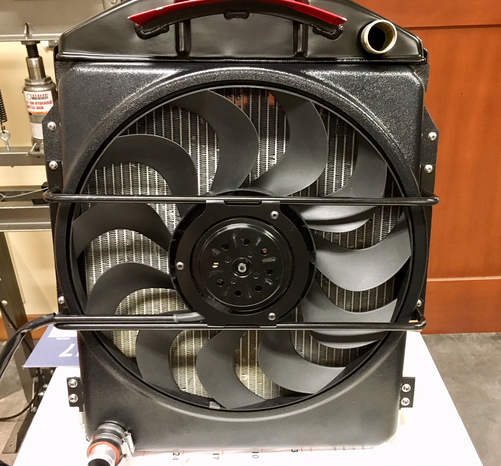

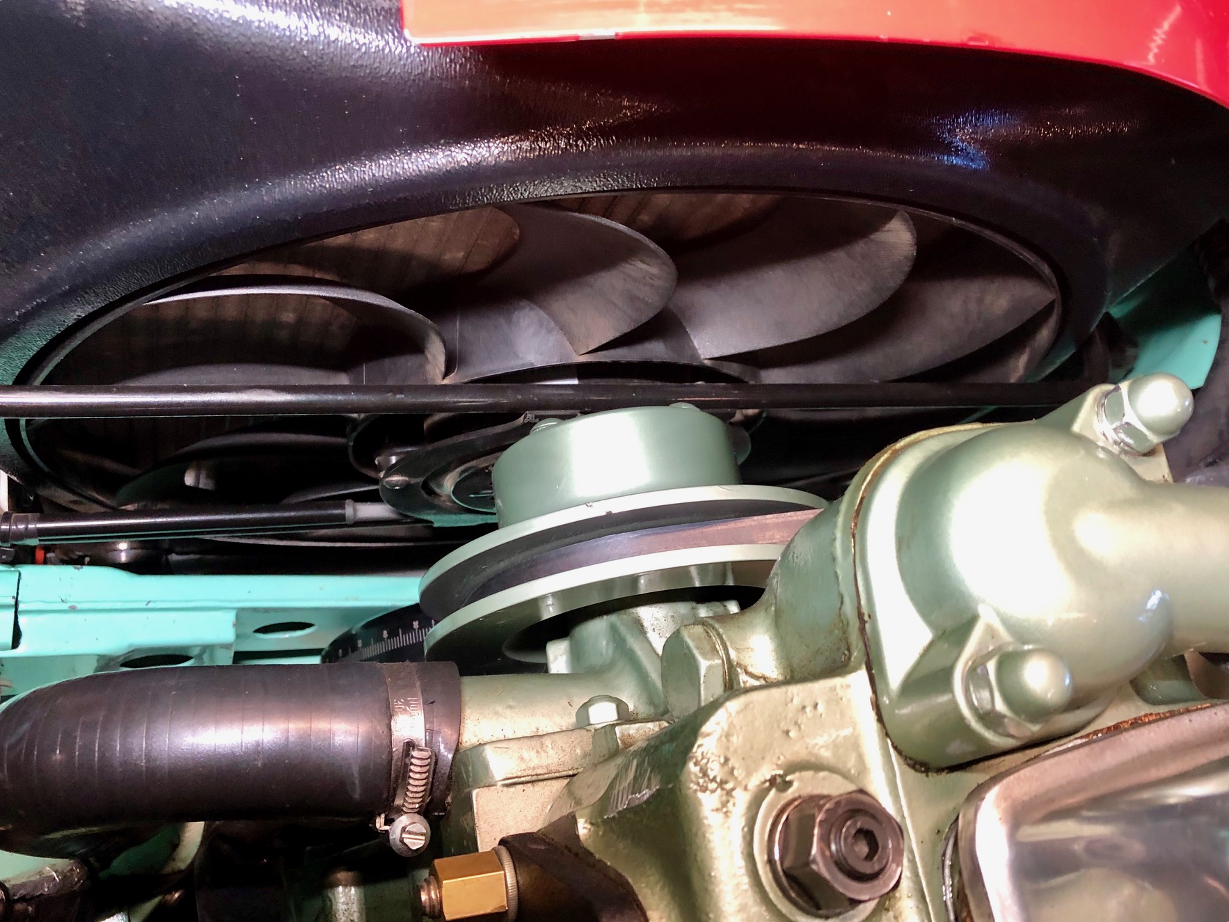

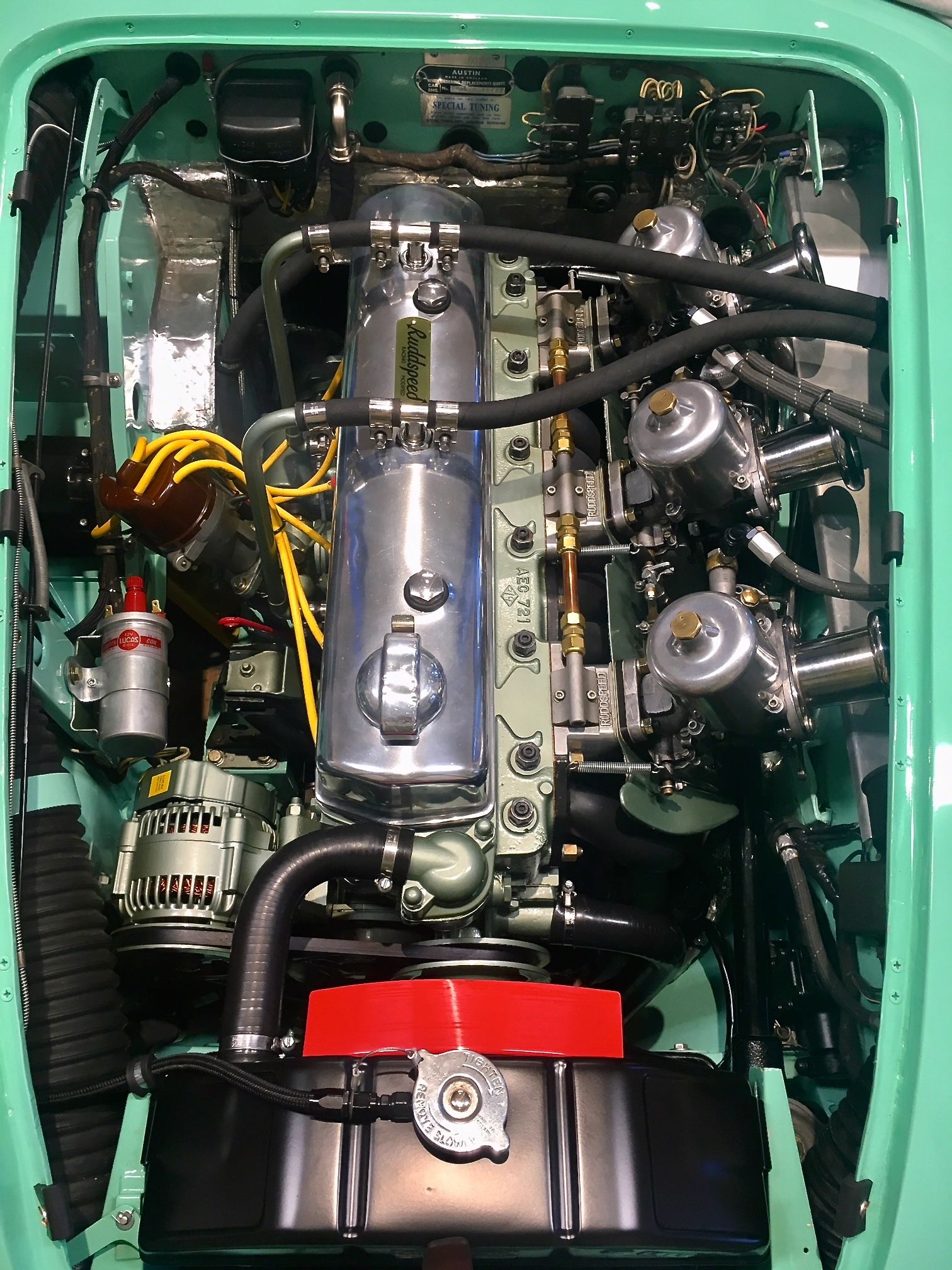

Been there and done that....Custom design, fabricated and installed. Race tested and proven!

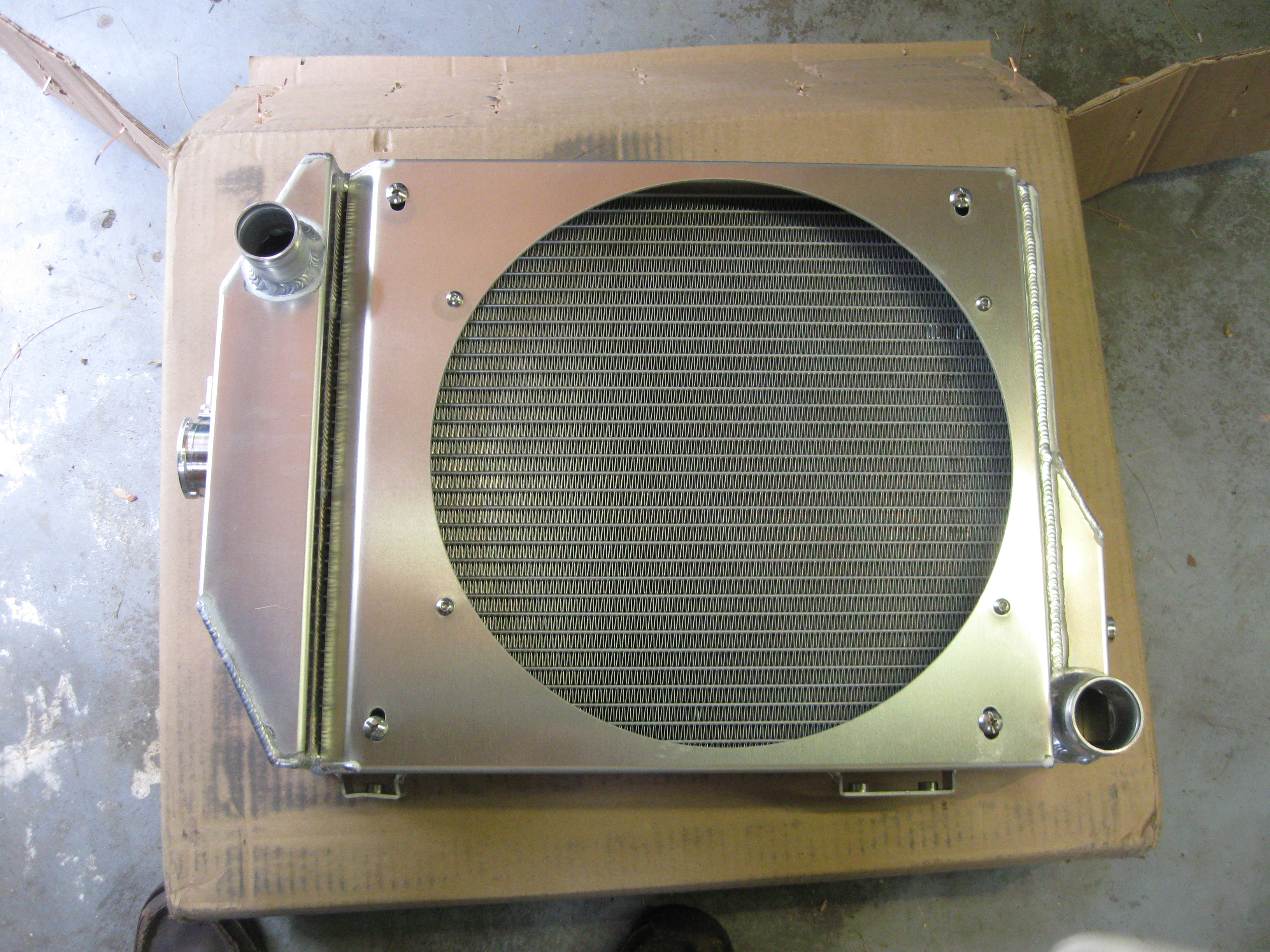

My effort to gain better cooling with a Chinese aluminum radiator also failed and it is for sale. But I write to say that British Car Specialties in California sells a two-piece steel fan shroud manufactured in Australia. I installed one on my BN7, which has a Texas Pusher fan, and it seems to have been to some benefit. Needless to say, living in Florida means engine temperature is always a potential concern with Healeys. I bolted the top ends the newly purchase shroud to either end of the red-painted protective piece that mounts on the engine side of the radiator. Pretty easy installation. Bottom ends use existing bolting points. Ever notice how Healey engine cooling elicits so many responses?
The Wizard with fan. $719.00
If they can do a pusher why can’t they do a puller!?

I've got nothing but good things to say about Wizard. Keeping a V8 cool in a Healey isn't an easy task, especially considering the space considerations that limit the size of a radiator that will fit. All the info I could find said a pusher fan isn't ideal as it blocks incoming airflow. Wizard worked with me to modify their Healey radiator to move the inlet to the opposite side to match the Ford water pump and add a shroud to work with the Maradyne fan I mentioned above as a puller. Their workmanship is top shelf with some beautiful welds.
