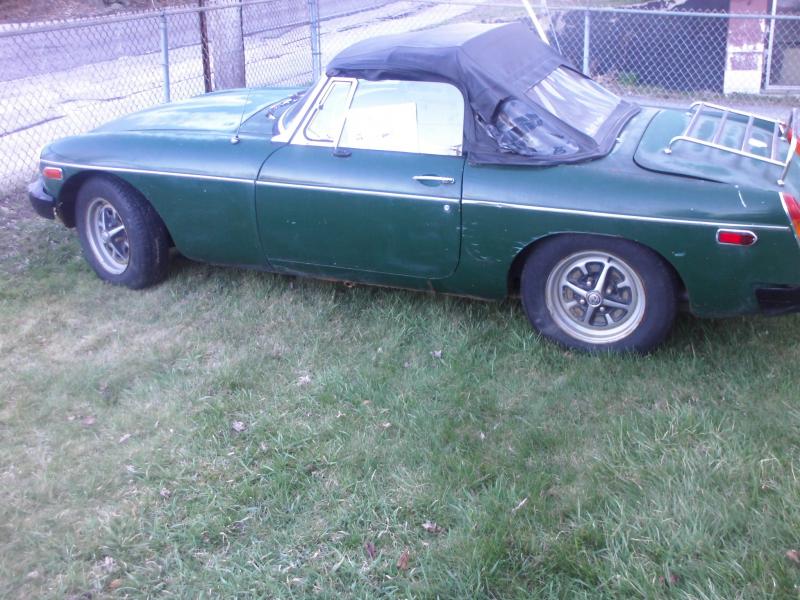

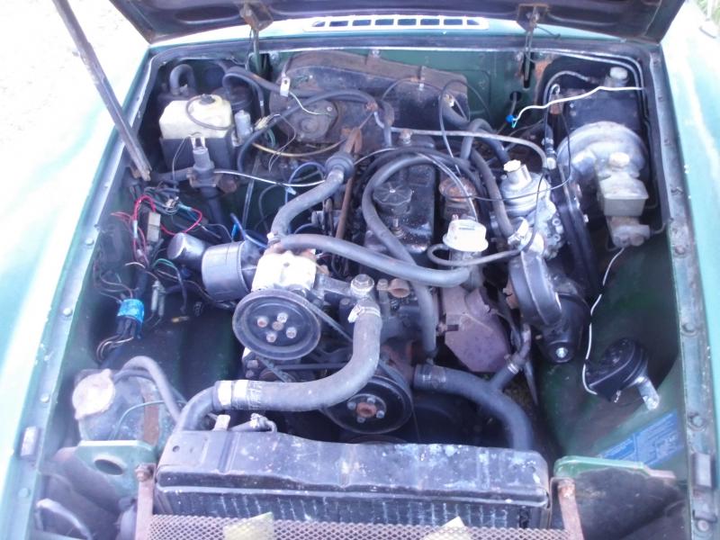

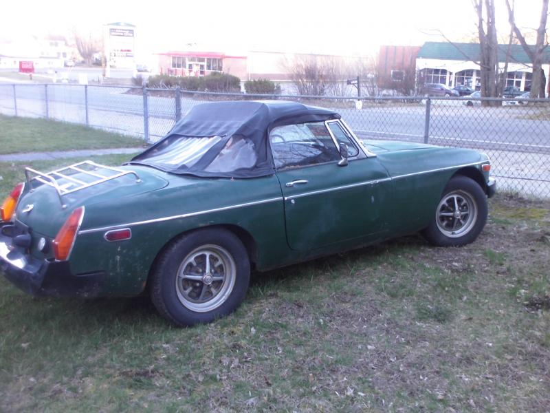

Venturing out to find a first project - either MG or Triumph. I've been looking at cars from say the 75-80 time range, and am slated to go take a look at a 78 MGB this week sometime. I'm curious what in particular I should be looking for on these cars. Specifically:
Body/Frame: Where are these vehicles most likely to show signs of rust (or have rust that won't be easily seen)?
Engine/Transmission: Are there engines/transmissions that are more problematic than others?
Electrical: Anything that I should watch for as warning flags for electrical problems?
Finally, what would one consider a "fair" price for a car in need of restoration? From the photos I have (see below), I can see that it will need paint and some dents and dings repaired. I've attached some photos, but the things that jump out to me are the relatively clean carb (good or bad, depending on what was done and how well), and some wiring that doesn't appear to be original (suggesting it may be time for a harness in the near future?). Asking price is $3,000, which seemed like it may be high for a "newer" car in this condition...

Take a magnet along with you and check bodywork all over, especially the lower section. These cars are really quite simple and make for an easy, enjoyable experience for a restorer.

MGB transmissions are as near bullet proof as you could get! They are very tough! If it has overdrive, that's a plus. PJ

As for rust, pretty much everywhere! Common spots are sills, doglegs behind the doors, floors, castle rails (looks like a frame under the car), rear wheel arches... Definitely bring a magnet and check for bondo, and poke around underneath with a screwdriver and see how solid things are. Mechanicals are cheap to work on. Bodywork is not cheap, even if you can do it yourself. If you have to pay others it quickly outstrips the value of the car.
MGBs are not expensive cars, and the later cars like this one even less so. Parts are fairly cheap, but any work you have to farm out is expensive. It's really easy to get upside down on value with these cars if you tackle a restoration or even just major engine or bodywork.
The best advice is to buy the best one you can. Take a look on sites like eBay at completed auctions to get a general sense of the prices of good condition cars, and then subtract from that the cost to fix this one up.

I sold an original paint 79 MGB w/ 42,000 mi. last summer for $5,000. BRG / tan & no rust. The underside still had the factory green overspray on the undercoating. In the top 5% condition wise ( I've owned a dozen MGBs over 40 years) yet it received NO interest when advertised nationally . $3,000 for the one in the picture above ? Did not know medical marijuana was legal in NH.
Joe Reed
I agree....just based on those pictures, that's no $3000 car. Does it run? I'm guessing not.....

Thanks everyone for the feedback. Looking at EBay, it looks like the $3000 he's asking is probably double what it is worth. I'm planning on stopping tomorrow to look at it but am told it does indeed run. Depending on the interior, I may offer up $1000 or so and see what happens...
