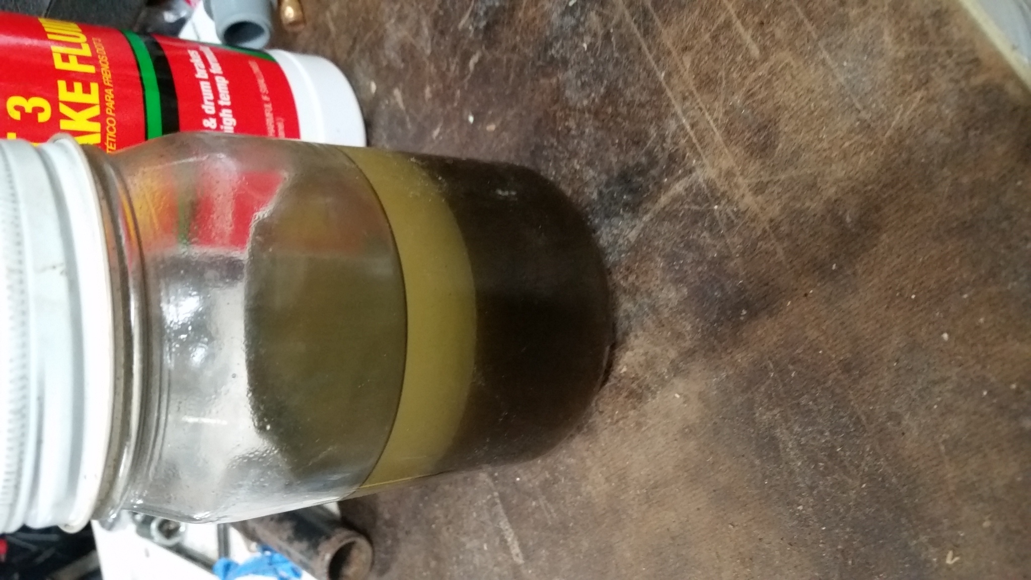

Drain the brake/clutch MC of old fluid and check for rust.
I am working on a TR3B for a friend and his clutch MC was frozen up so I gt a new one. Before remving the old MC I sucked all the fluid out of the reservoir. The car has not been driven for a while possibly 10+ years.
This is what came out.
