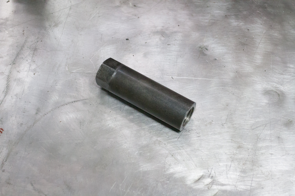

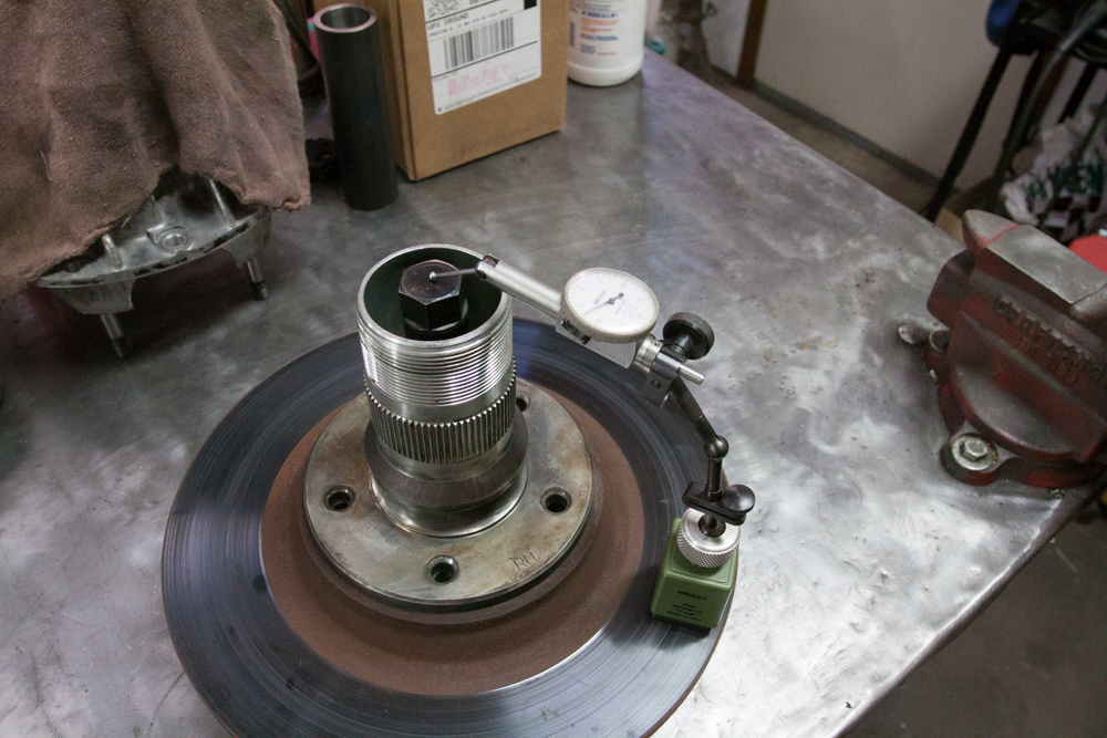

If playing with the shims, I oil the bearings and don't install the inboard seal. Install the inner bearing on the axle. Slip on the hub. The distance piece sits against the inner bearing's inner race. The shims go in next, followed by the outer bearing. I start with too many shims. Then the heavy washer and the castelated nut. I made a nut that sticks out of the hub. Use a test indicator with a magnetic base to measure the slop. The magnetic base sticks to the brake rotor and the indicator point sits on the nut. Push the hub in/out and read the distance the hub moves on the indicator. Adjust the shims accordingly. If the indicator says there's 0.010" play, I might only reduce the thickness of the shims by 0.008". Sneaking up on it. The hub should rotate freely with no noticeable play when you push/pull on the hub. When you're happy with the shims, take it apart, grease the bearings, set the inner bearing in the hub and install the seal. Put it back together.

And the dial indicator setup can be problematic if you've got wire wheel hubs, BTW.

Here's a mock up of the test indicator set up I use
I made a nut that extends past the end of the wire wheel hub
That's downright sexy, Bob! ;)(y)
My rig was crude. A piece of steel coat hanger wire threaded to fit the dial indicator stem.

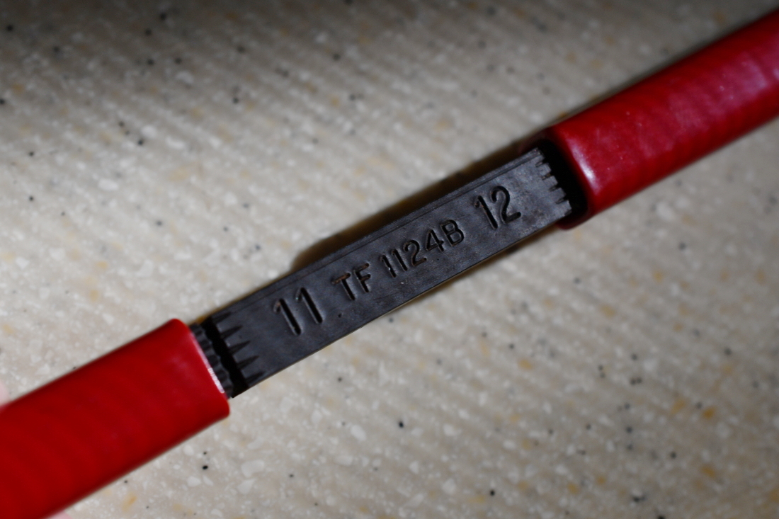

After some research, I don't think what I posted a little while ago is correct. I think that front axle stub is 16 TPI 5/8" UNF, and I should clean it up with a thread file. I've never used a thread file before and I don't know if any 16 TPI file will work, but I'll figure it out. Advice appreciated!

Snap-On thread repair file, you may find one >>> on Ebay by part number. <<< 11 tpi through 24, useful tool.
5/8"x16 tpi UNF sounds odd, though. Standard is 18 tpi.
Platinum
IMHO a thread file is a "choice of last resort." A thread chasing die would be better. As for pitch, anything you do to clean up or "repair" damaged threads is somewhat destructive.
