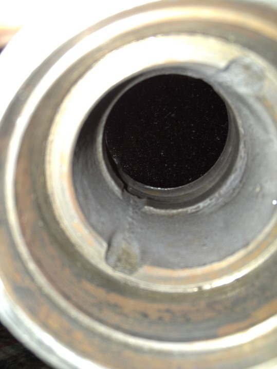

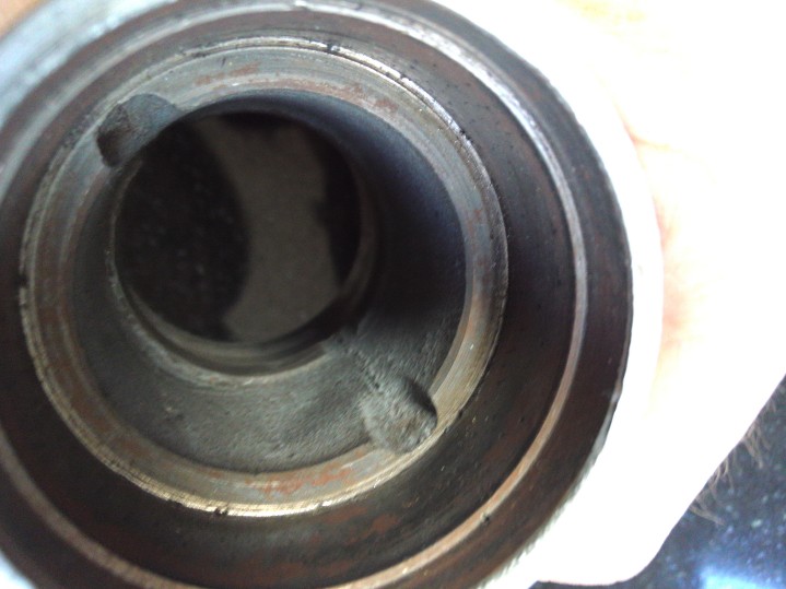

Gerard
Jim,
The wheel bearing need to be driven out by the outer race, especially if you plan to reuse them. You'll need a long thin rod or snub nose punch to do this. You will need to enter from the opposite bearing and catch the edge of the outer race where it extends from the hub casting. There are actually two angled cutouts, 180 degrees apart, to give you a better purchase area. You'll have more room though the rear bearing, so do the outer first.
I just remembered about the spacer. You'll need to knock out the center race of the outer bearing first.
I use a long 1/4" dia. steel rod. Cleaning out the grease so you can see better will help. Work both sides evenly.
