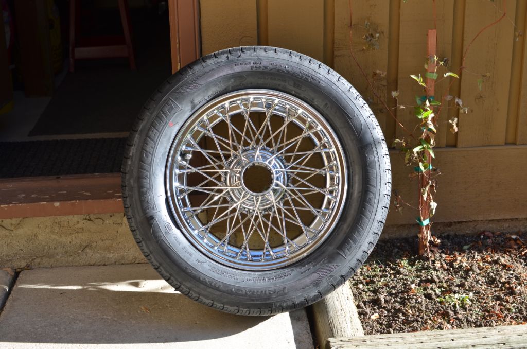

I have 195/65R15 Michelin Primacy MXV4's on Dayton 5" 60 spoke wires. I felt the 72 spoke was a bit of overkill.
I think the diameter is close to stock so the speedometer (if perfectly rebuilt) has very little error. That's the theory anyway.
My presures are set at 26lbs front and 30lbs rear.
