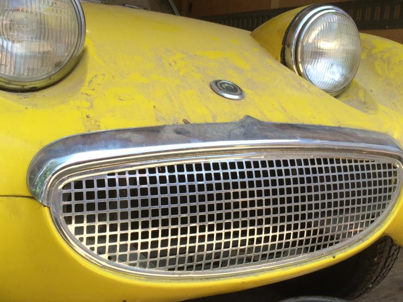

The rubber on my FrogEye is past best buy date and I am going o buy new tyres .I run the 145/13 now but have found 155/80/13 that looks good .Question will these fit without clearance problems?

155's will fit just fine, and in my opinion they look a little better than 145's.
