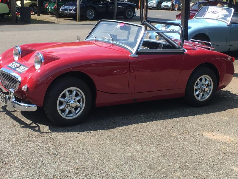

I know the alternative seat options has been discussed on previous forums for the frogeye but would like to know if anyone has had any new options recently either with new competiton seats or from cars like the Mazda mx5. I have a roll bar fitted and think this would need a fairly narrow backrest on the seat in order to clear. Also issues with accessing the boot which I know will be restricted. The other option I have is to install headrests (protection) to the roll bar but I cannot seem to find a supplier. Any help please.
Can you supply a picture of your roll bar in situ? I think that might be the easiest option. A metal plate bolted or welded to the bar. A matching plywood base to which a local uplostery shop could fit a matching vinyl pad. Or a set of seats from Cobra https://www.cobraseats.com/retro-seats.asp .

Thanks Paul I was looking at the Cobra roadster 7 but not sure of the mounting and whether tilting was possible to gain even a limited access to the rear, looks narrow enough to clear the roll bar. CC54FC52-57A6-46E4-BE11-FCF13CDB32C8.jpg
I think the Cobraseats are a good choice for you (UK based and a phone call away). They have been fitted to the B/E before. You can tilt your seats backwards by sloping a wood filler strip between the floor and the seat frame ( gives you a little more leg room) Getting access to the boot will be your problem ( tilting forwads). Your roll bar is in the way already. It is a little tricky to mount headrests on it for for the passenger. You would have to do some fabrication for both sides.

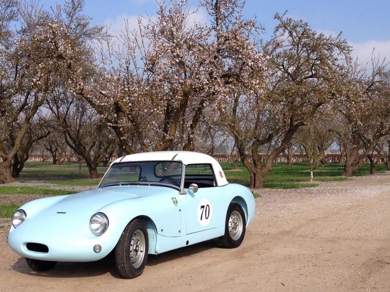

Ask and you will receive.
Of course you know what it started out as ��

Thanks for that input Paul and nice pics by the way, Cobra seats look a real possibility I think fabricated pads would look a little ugly as the passenger and driver side would need different brackets unless I removed the diagonal which does have a covering of padding I have not covered the top because as it is now I can still use the hood. Not too fussed about access I may be able to design a quick release system to take a seat out for access to spare and a good excuse for not taking too much baggage.
The wheels are minilite with knock on adapters a bit heavy but feel good on the road and I use beefed up half-shafts from Peter May.
Doug I will get some dimensions for you of the roll bar it is bolted to the floor and the wheel wells and does not involve making holes in the rear shroud so converting back is not a problem, the bar does make the frame stiffer and should offer a little more protection from being t boned as I have been in the past (usually on roundabouts which I don’t think you have many) I am a bit worried of a shunt from the rear that is why I would like head restraints.

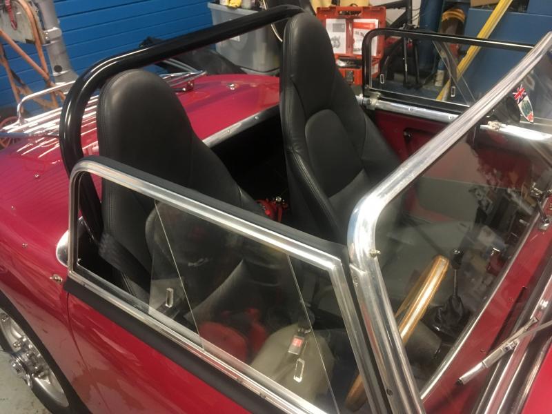

Thanks Jim I think I will take the plunge and bid on some Mx5 seats as you say mounting looks easy to modify, I will look out for an Mx5 or its seats locally and try and get some measurements to make sure it is not higher than the roll bar.
Hi Jim
Got the seats real quick and got them in even quicker thanks to your previous post. The roll bar was always going to be an issue but as it happens just had to remove the diagonal and I was lucky the vertical part of the bar cleared just ! I just had to shave a bit off the plastic trim around the hinge to get that extra 1/2 inch. Bonus with the hood up plenty of head room without taking any foam out of the seats as has been suggested on Mx5 forums. I’m just a mite under 6ft. Took her for a test run tonite and it’s fabulooooose.9F7EB687-FFC1-4C89-BC66-3D670706A2AE.jpg468C54F3-49E4-483B-8DD7-AF4A69CC99C0.jpg
