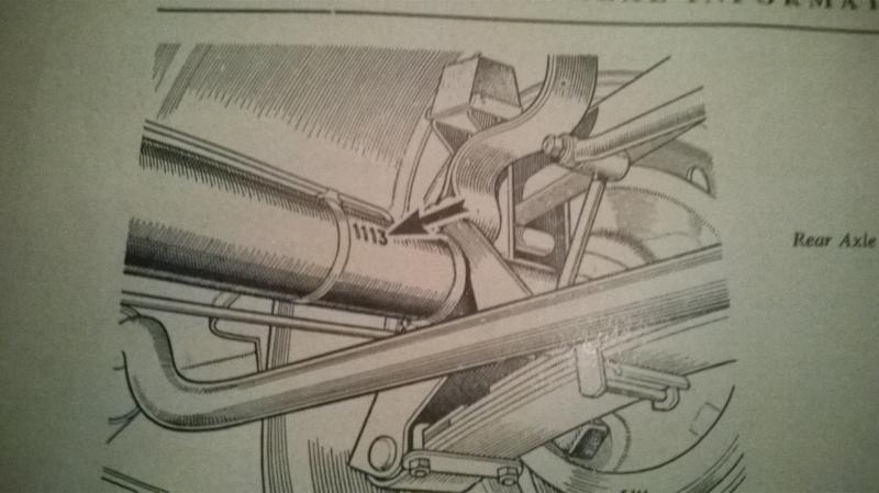

Does anyone know if the stamp number on the rear axle housing is available via the Heritage Certificate ?
Thanks
Lew
drooartz
It wasn't on mine -- only has chassis (VIN), engine, body, and key numbers.

Unfortunately this car is missing all identifying "traceable" tags including the BAE. Only tag on the car is the non traceable Factory Commission # AN530252 from LHD driver's side door pocket. That number approximates the build date to Jan1960 and the detective investigating the criminal case against the seller has used that date to identify two possible VINs registered to previous owner, who is now deceased. He obtained from HMC car details for both cars, so I have VIN, BAE and engine numbers. Both unfortunately both cars were also Antique White with Red trim (same as my car) so that did conclusively identify the car. Hence the question about axle housing number ....
Now trying to "match" one of these two VINs to the North Carolina numbered window registration sticker from 1987, and hopefully that will help obtain the title.
