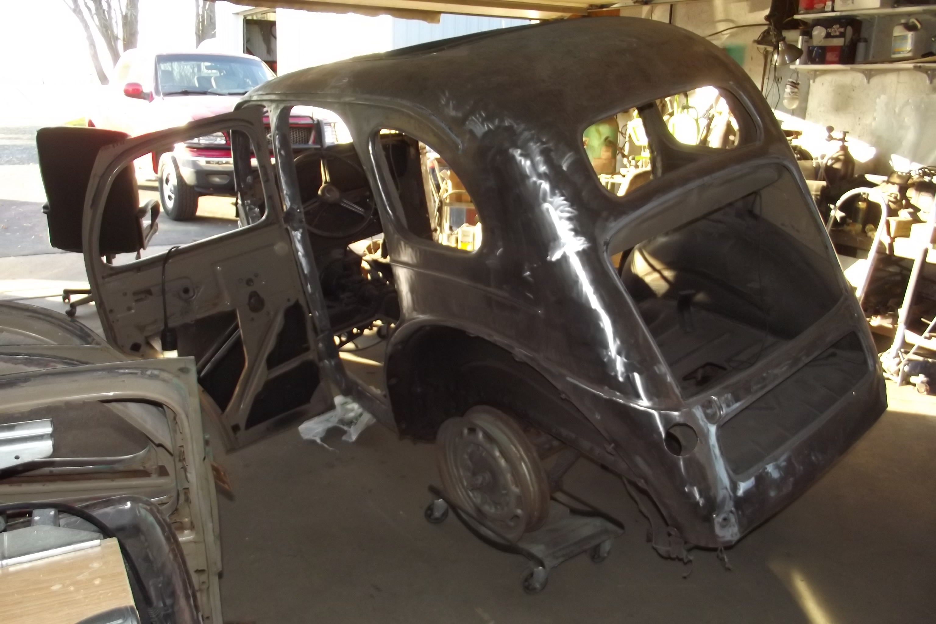

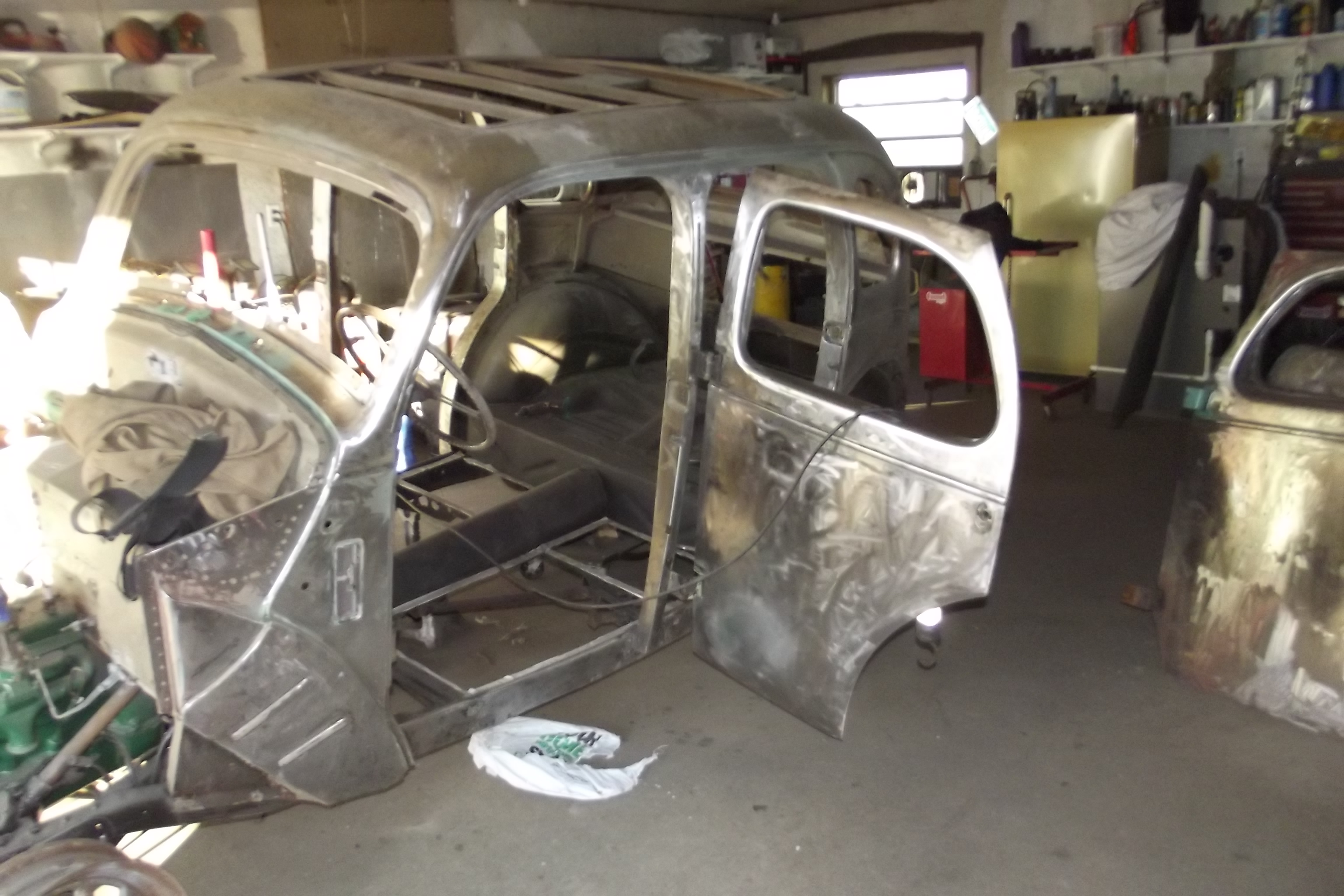

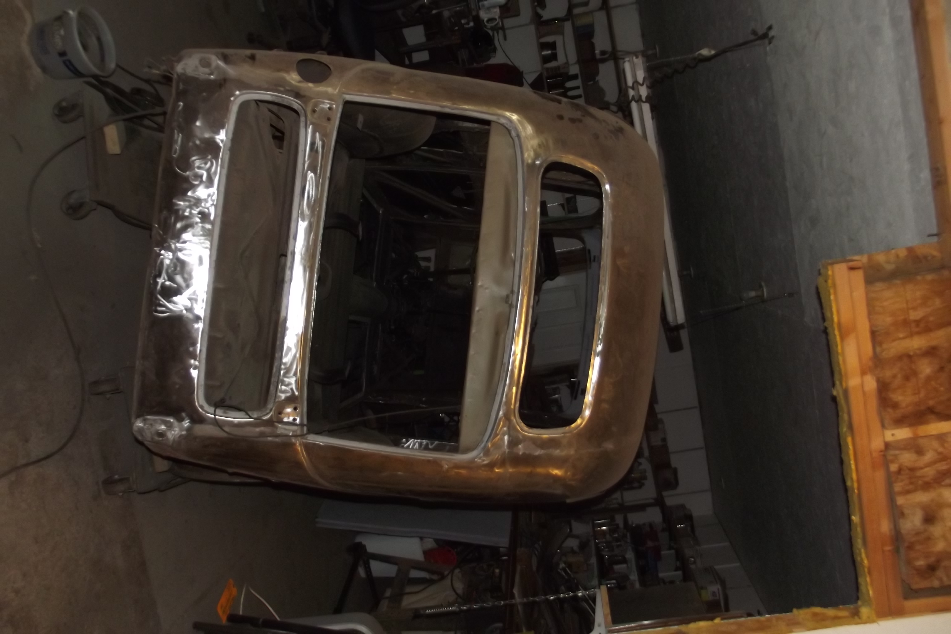

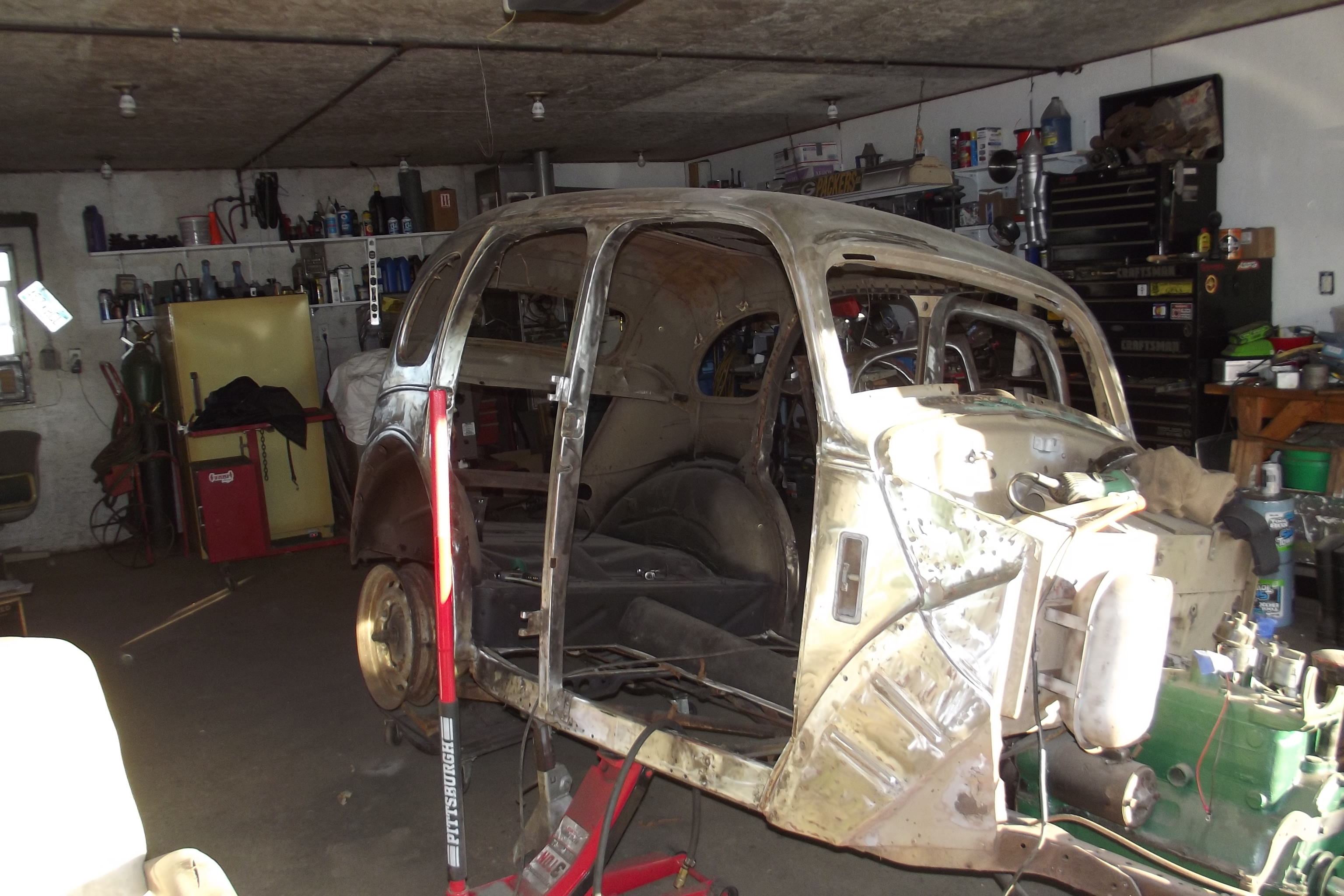

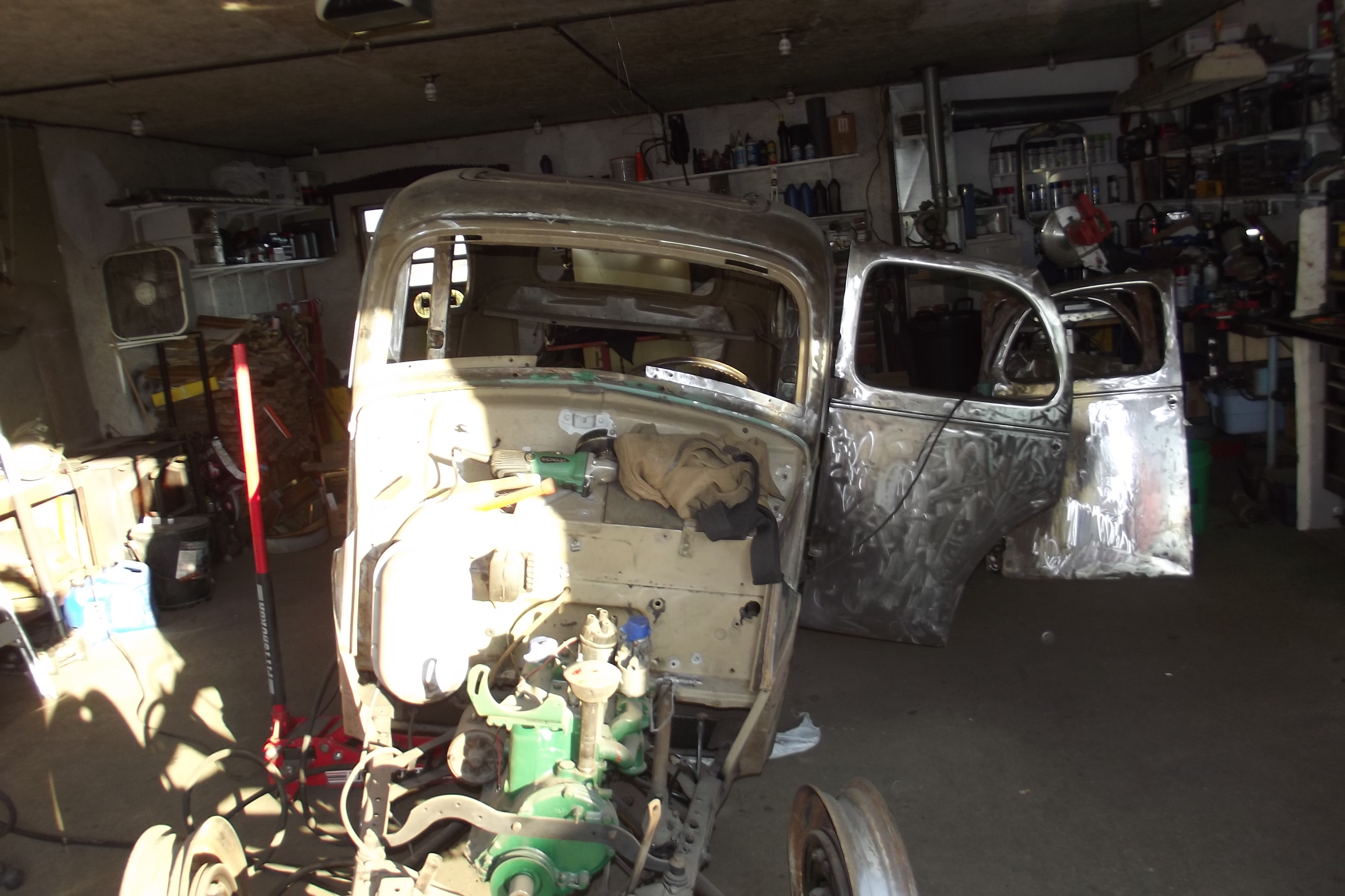

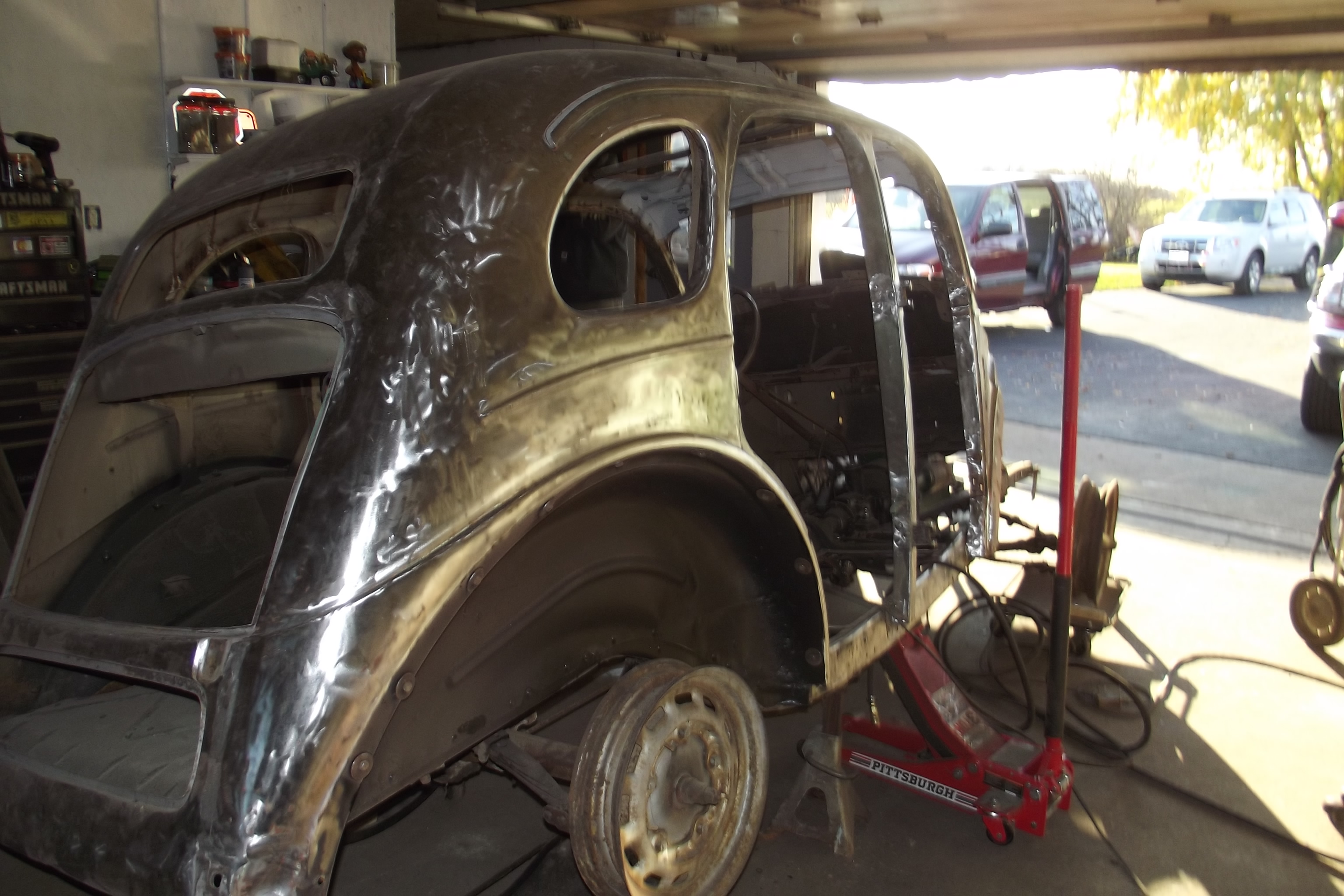

Today is paint day (I hope) she is down to bare metal her factory suit was some kind of horrid beige or tan then someone decided to paint her dark green then a light green and finally a dark green on everything above the body line and light green below, that is a lot of paint. Next, we get to the doors and the fronts came off without too much trouble there is a drain tube on each lower corner of the windshield opening which was purposely put there to make life miserable and the slotted screws that bolt the hinges to the body on the rear doors will not come loose I have tried the air chisel to vibrate the rust loose which did nothing so we had to drill out the pins as they were fused into the hinge. The first coat will be an epoxy followed by a high build primer, once done I can push the car over to the other stall and get to work on the doors and fenders oh and hood, I have been lucky so far and the flash rust has not found me.

You have made some serious progress. How did you strip the old paint?
With a 4 1/2 inch angle grinder, DeWalt Orbital Sander a mouse, and angle air tools no chemicals.
That's how I plan to strip mine too.
empireabrasives.com you want the surface conditioning Disk 4 1/2" X7/8" about $35.00 for 5 disks and it will take at least 10 disks, for the drip molding I used my sandblaster to get in deep also if you have a soft top it will be needed for the deep recess of the flange. I used my DeWalt 5" DA Sander with 80g for the cleanup and a lot of 3m discs for the 3" angle air tool. If you have to remove the doors which is a pain as they welded the door hinge the front are bolted top and bottom but the back doors are another story as I could not get them to turn so I had to use a pin removal tool I bought from Bob Drake as it works quite well unless the rust monster welded the pin then it is drill time.

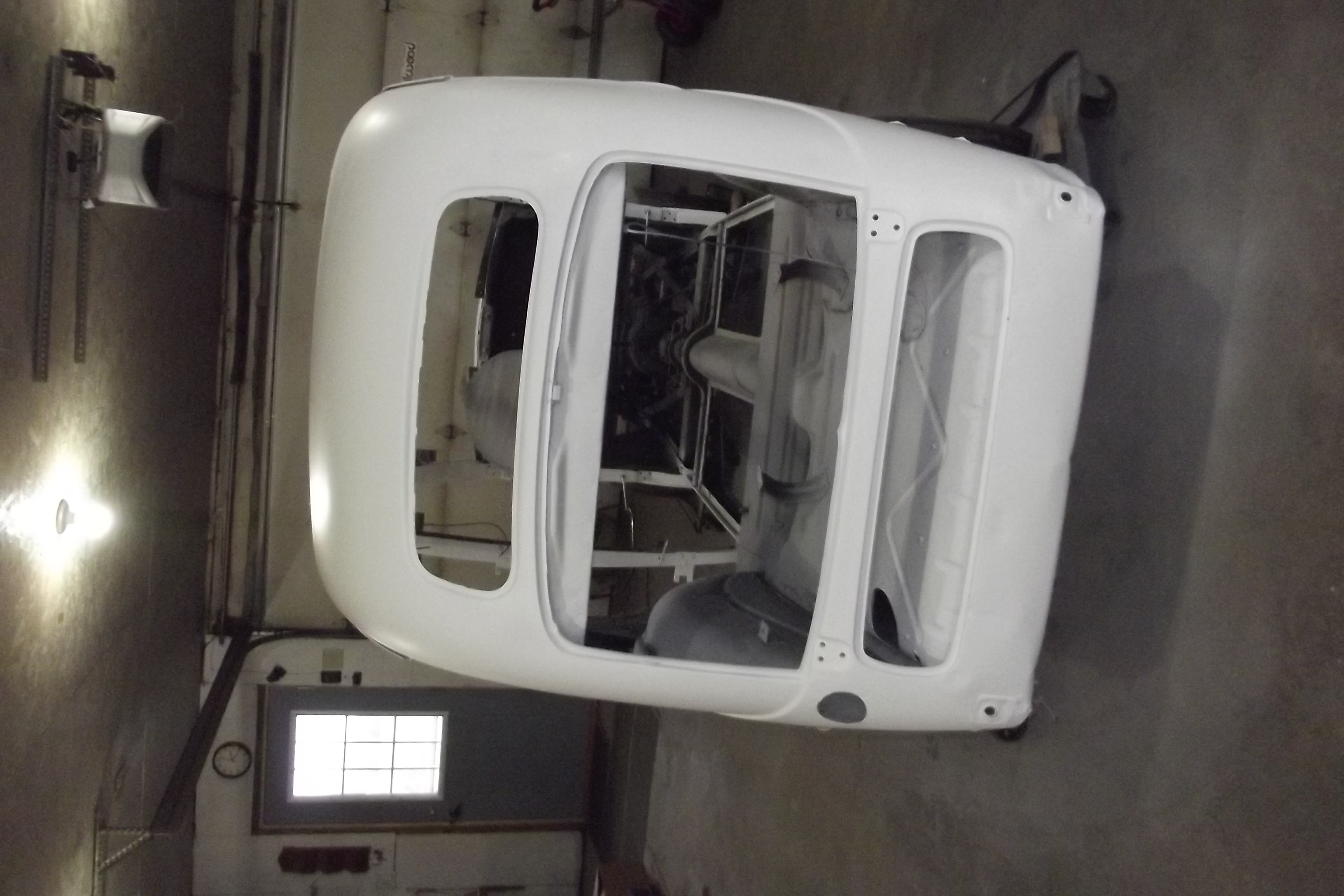

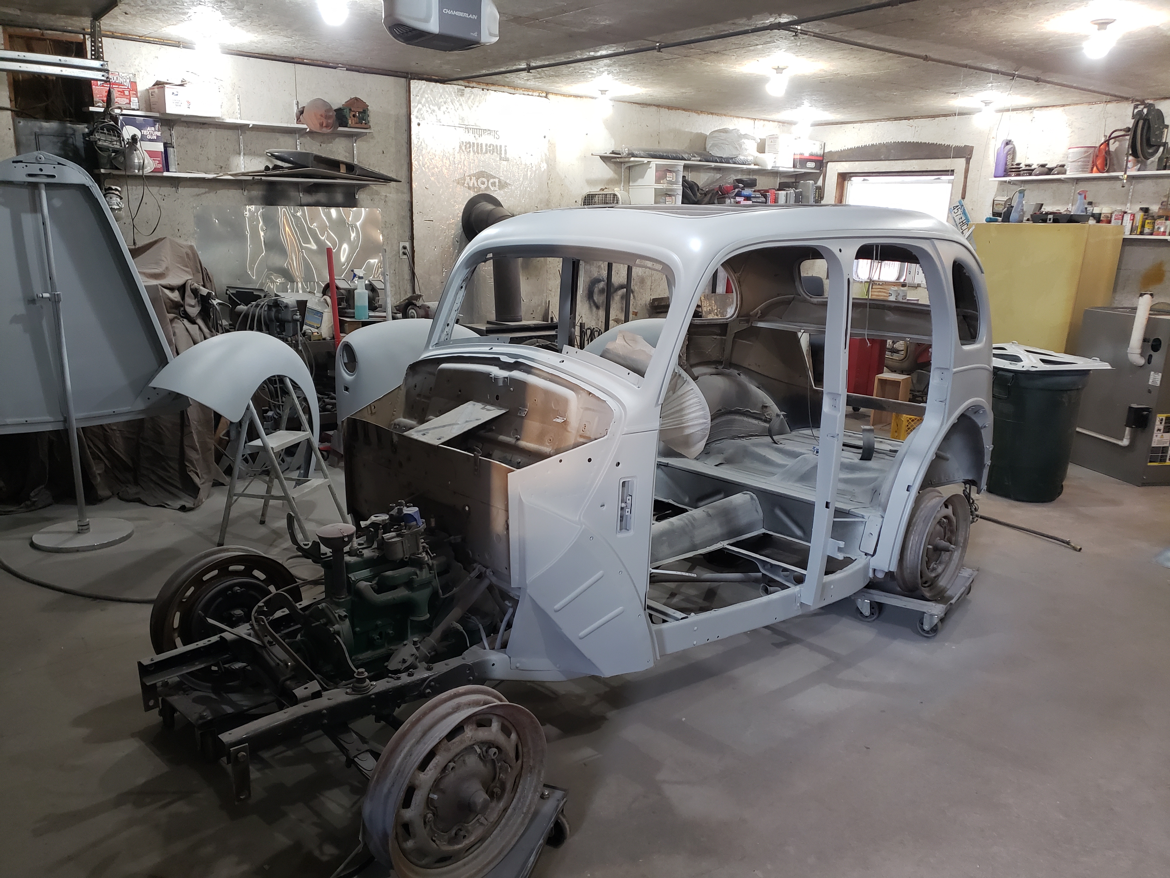

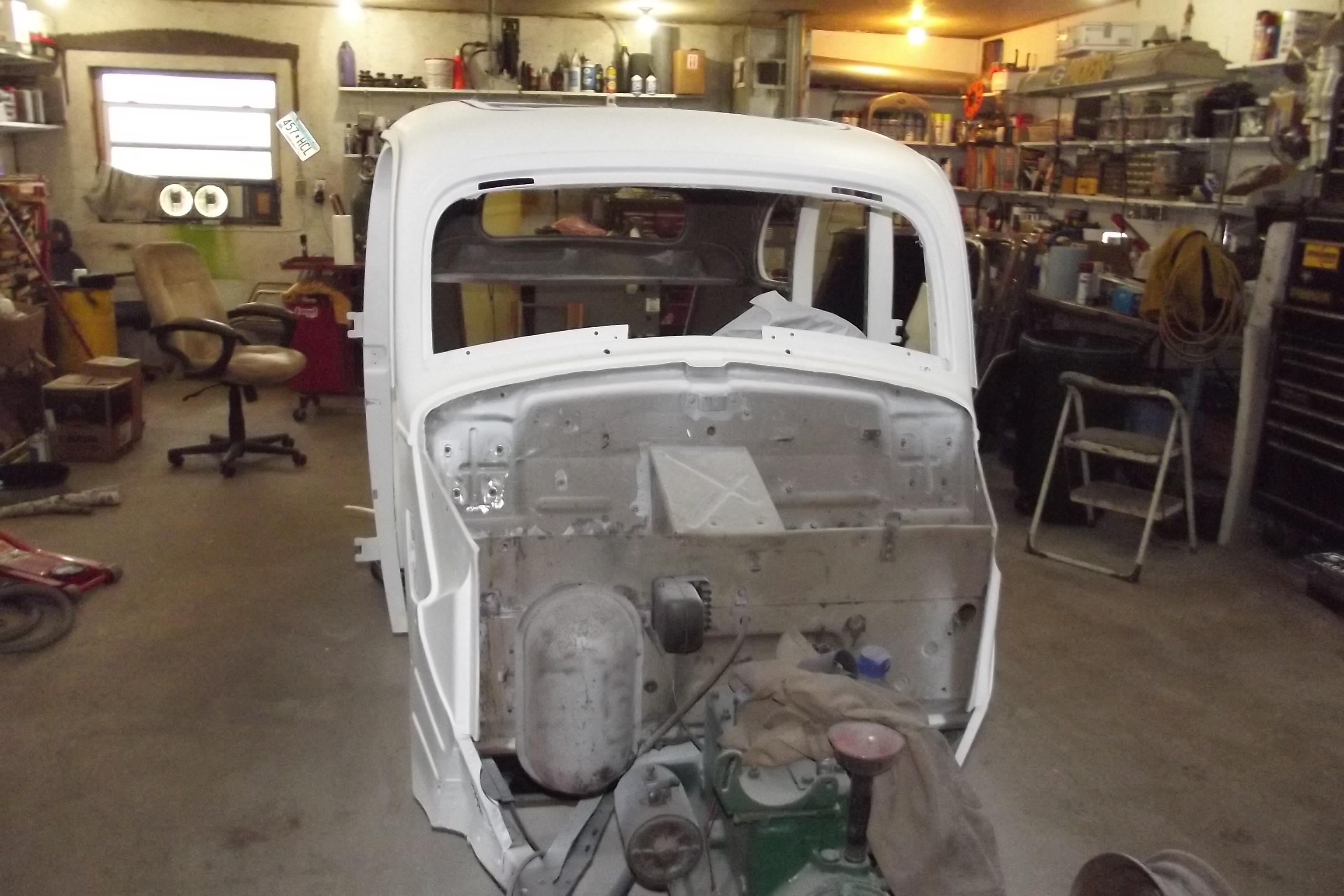

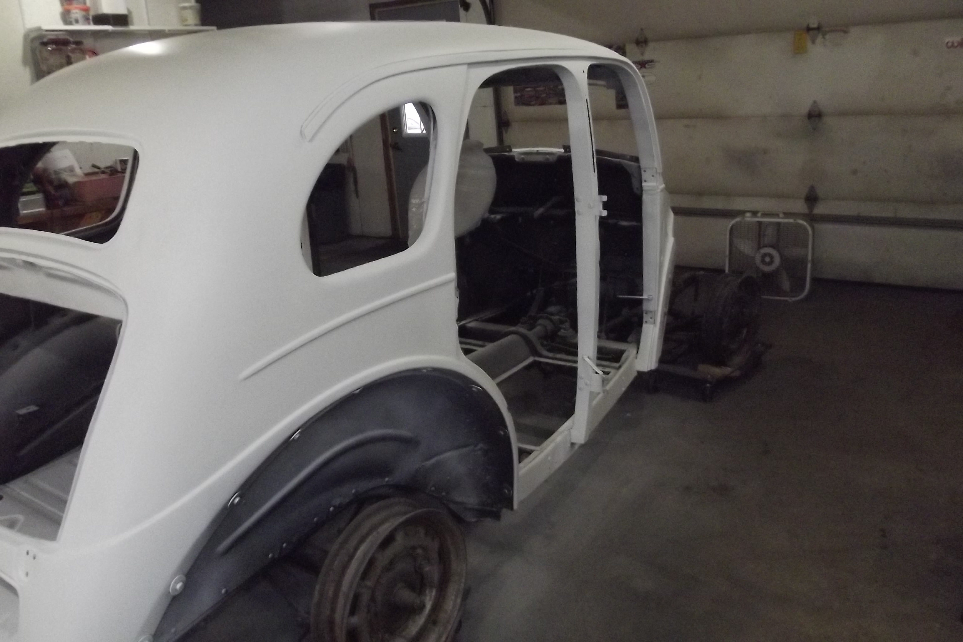

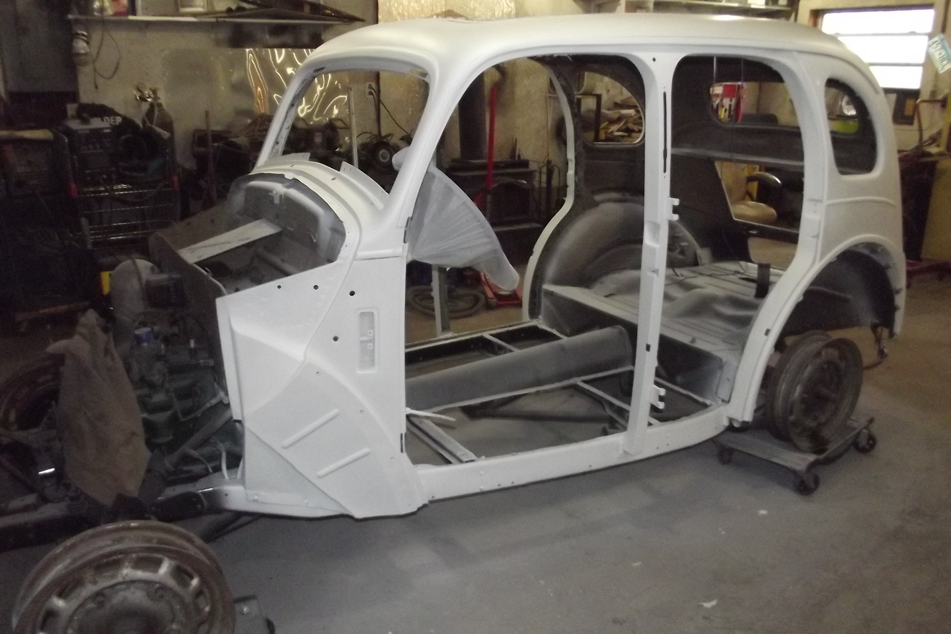

Good luck, here is the epoxy primer on the body, there are a few small dents and one large one that I will have to use the stud gun to pull the dent out. It will get bodywork done now and then I can spray the high build primer. Still have to strip the doors, trunk, and hood.

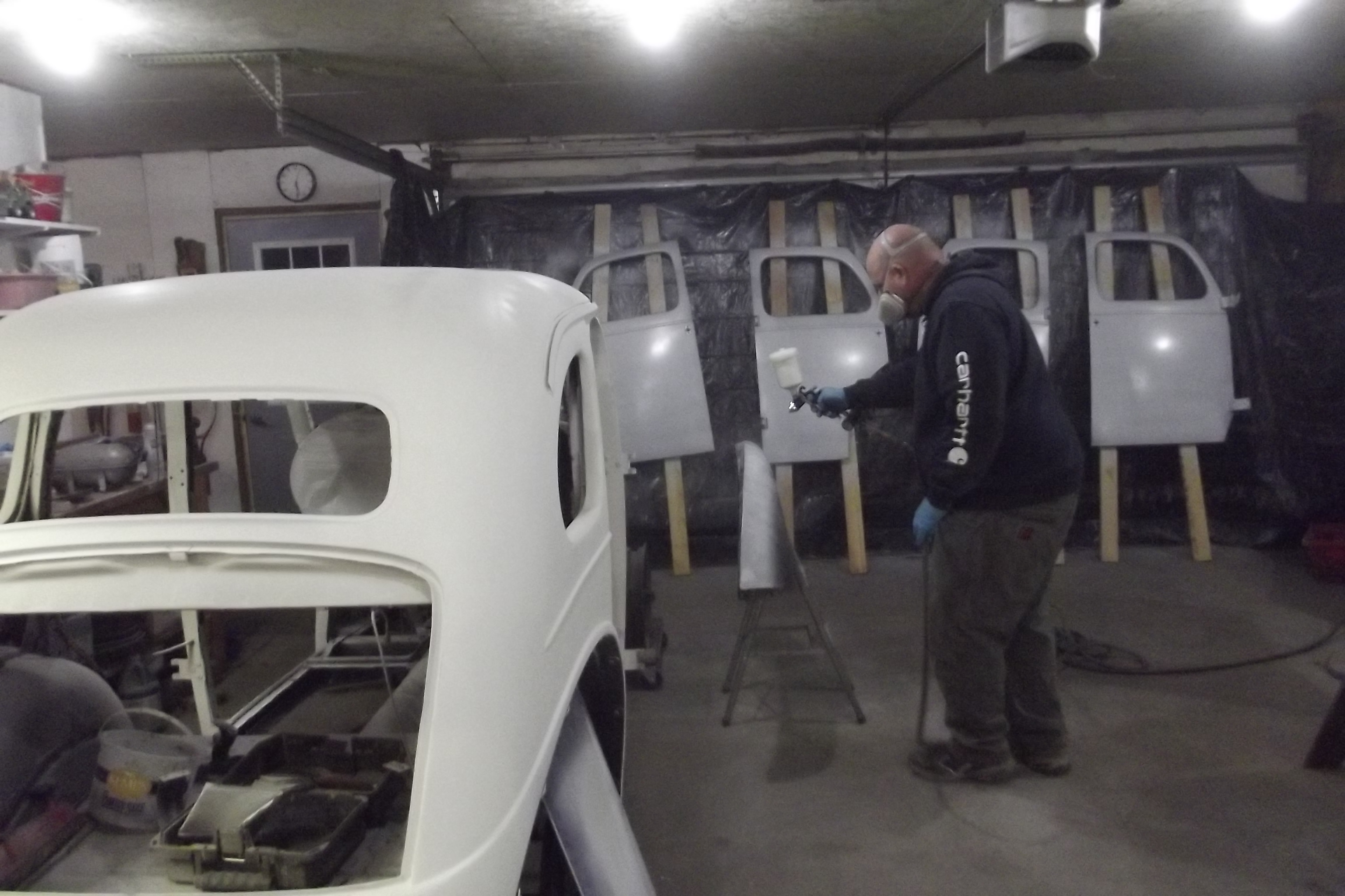

I will be doing high build DTM primer today

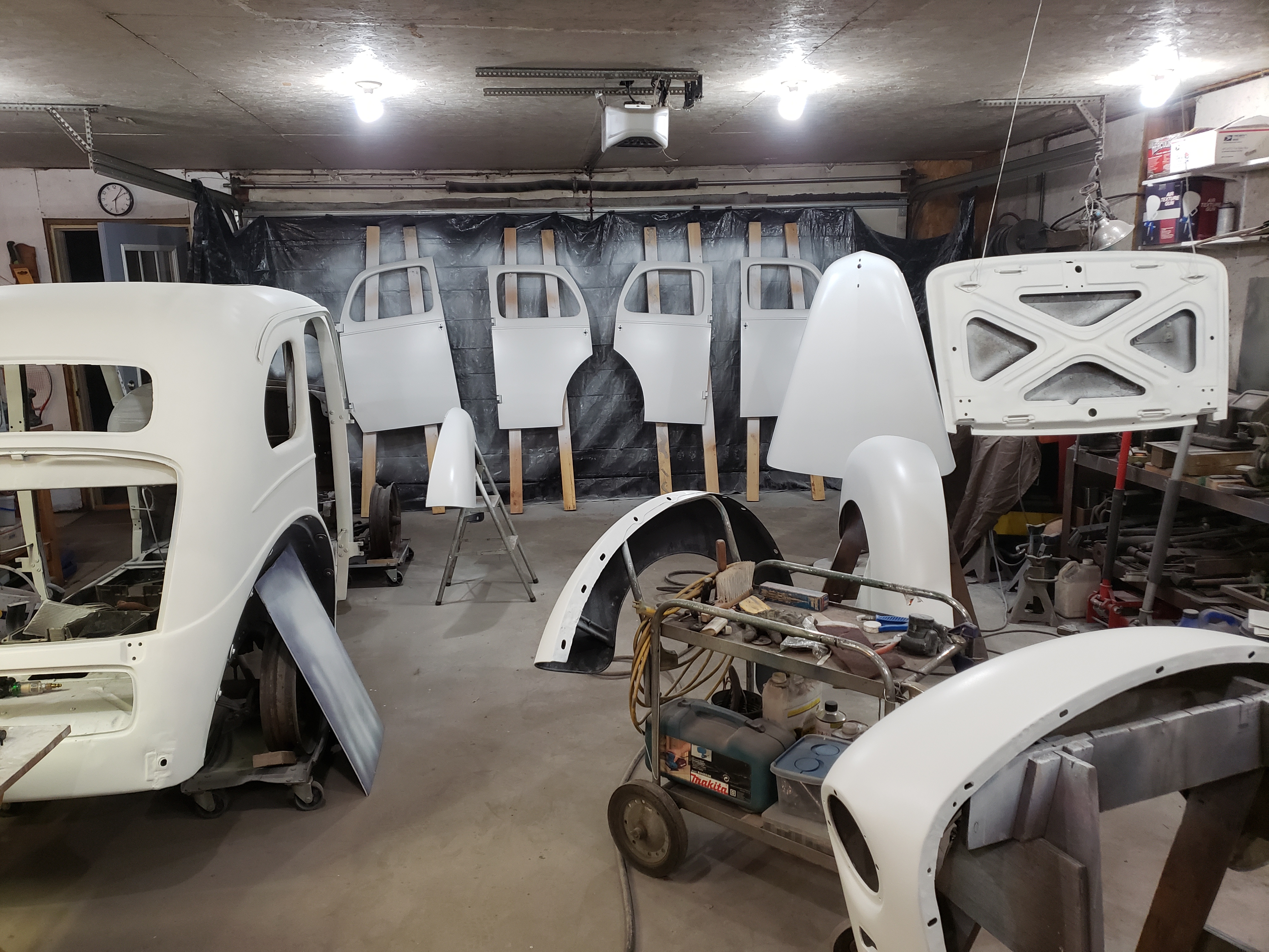

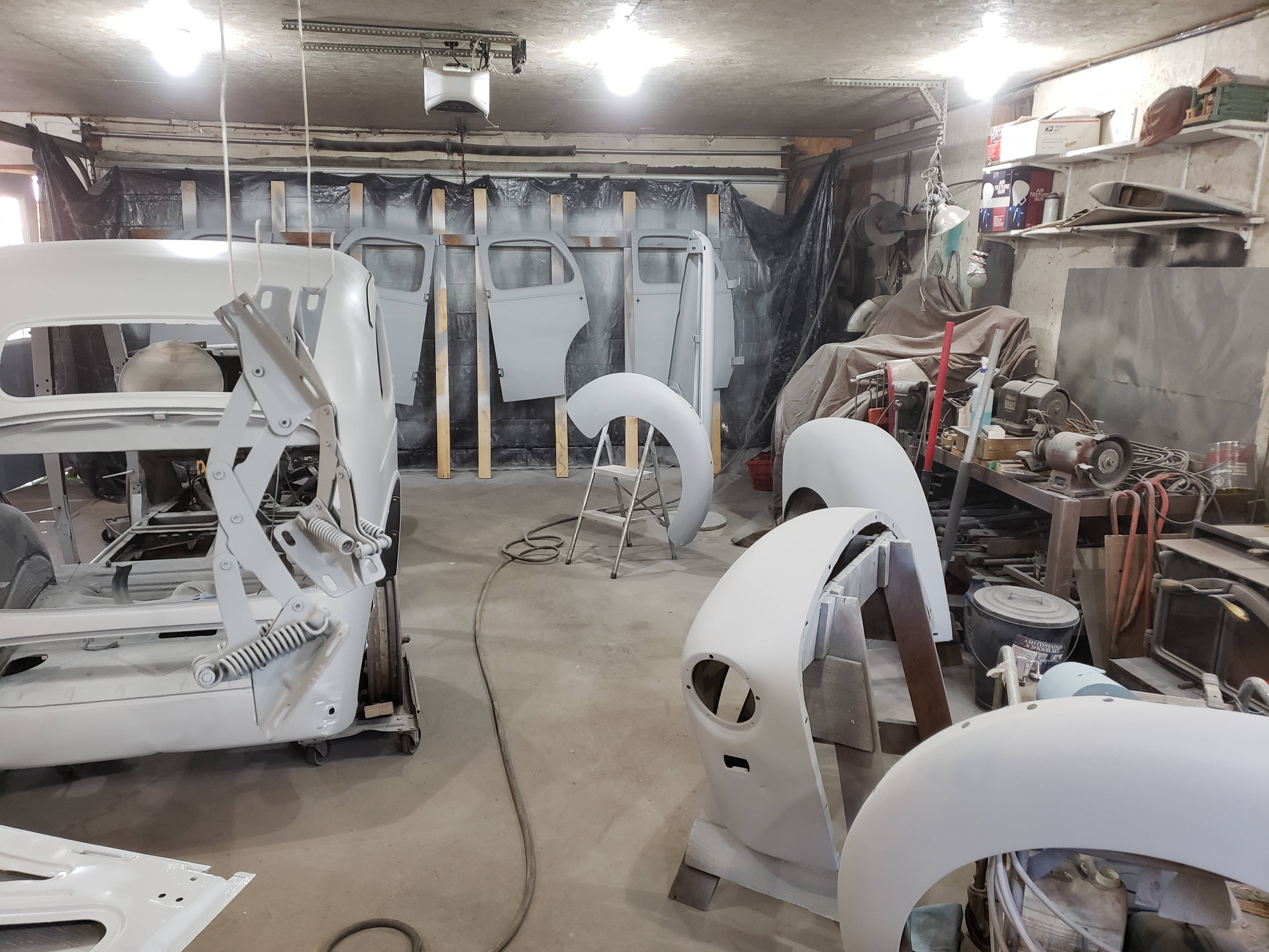

Running boards are like new just need to paint the bottom outside edge black and the bottoms all done, I really hate the hinge pins the driver door top popped right out and the bottom was another killer, broke the second shortest pin off in the screw bolt and then broke the drill bit trying to get it out but-but I happened to have an old tool so I was able to salvage the screw bolt and the bottom hinge we had to hacksaw the pin top and bottom. The middle fell right out and it had kroil on it but I had to use the flame wrench almost to melting what a job. I got the rear door hinges of the B pillar by heating the screw head cherry red and using one of those slammer tools that twist the screws came out. Was going to put the sanding primer on today but I had a Vet appointment for Oliver (dog) and Luna (cat) the latter is getting her front nails removed she is a rescue cat that has been adapted several times and returned several times due to ripping furniture and ripping screens. Will put the high build on tomorrow and spend the rest of the winter block sanding and color going on in the Spring.

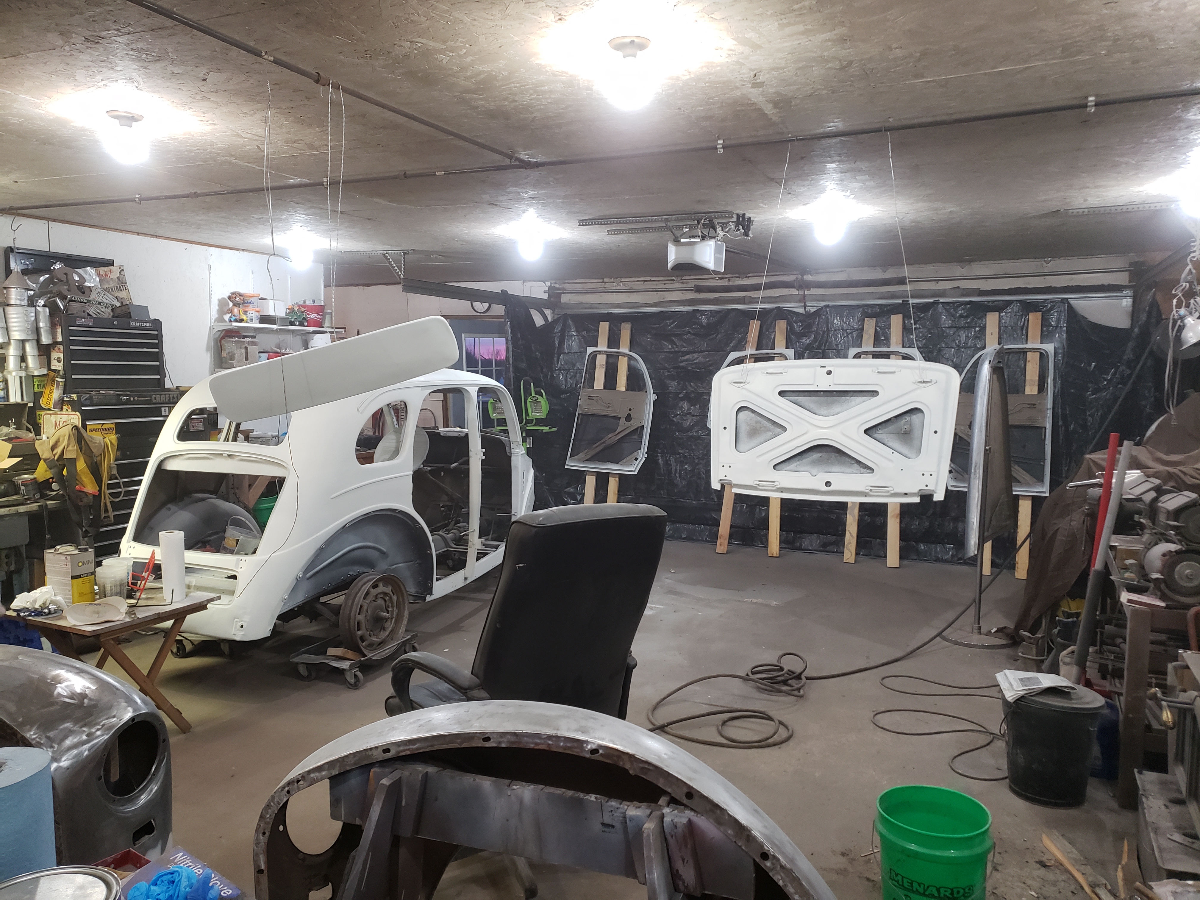

Now have the sanding primer on and will wait for a day to start block sanding, I do believe that we are going to paint the color panel by panel as the color is not metallic just your basic single-stage urethane if it were metallic we would have to assemble the car, I would have liked to do a base clear but the funds are not there.
Looks great so far. You are really moving fast on this. Which high build are you using. I have been using Slick Sand and have come to really like it.

I am using Gray DTM High Build 2K Primer Surfacer (Direct to Metal) 2.1 VOC, 1-1/4 Gallon Kit - Fast Dry High-Performance Primer -
