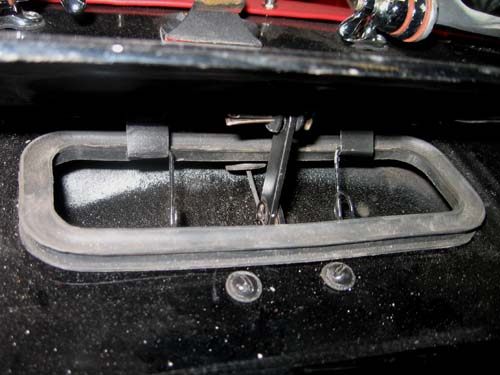

Below is a pic of the scuttle vent assembled. The fulcrum mechansim attaches with the screws shown in front of the gasket. It also holds in place the spring. The opposite ends of the spring slide into the vent lid. I'm pretty sure that I put in the fulcrum assembly first and attached the pull rod, along with the spring kinda hanging down. Then I screwed on the lid and slipped in the springs ends and then attached the fulcrum end to the lid.
The first time you do it should drive you nuts. :jester:

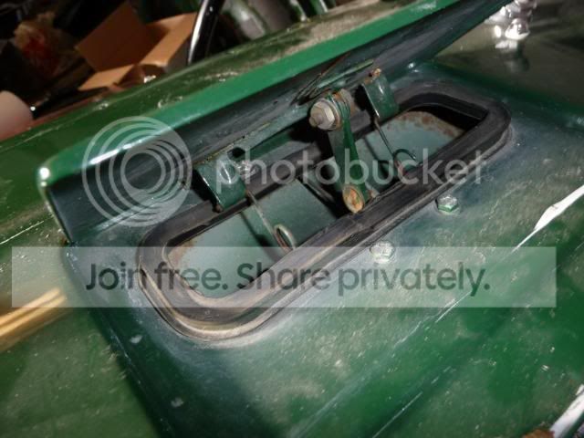

PS Here's a picture I took that was suppposed to help me remember how to put the vent back in.

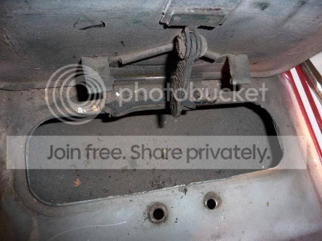

Don't know if they will help, here are a few shots from my TR3's during disassembly.

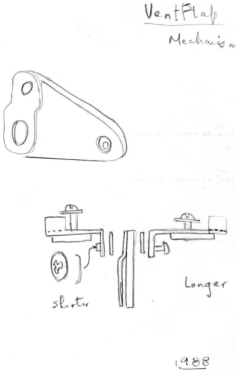

Here's another sketch I found whick I drew in 1988 while I was taking my 1958 TR3A apart for the full restoration.
