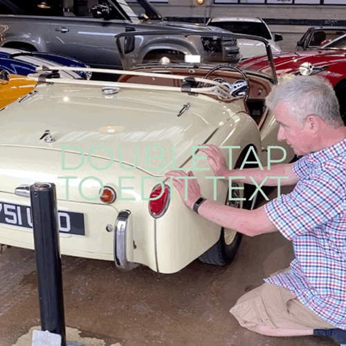

This is it to just show how bad it is - and the pushing want particularly hard!!!

Definitely shows the sideways shaking on the rear body. Does it do the same when pushing sideways on the front wing/fender? The wheels are moving sideways too. Not good.

There’s no movement of wheels in relation to the body - look at the wheel in relation to the rear fender, and you can see the front going in the opposite direction. The movement appears tyres which you can clearly see in the vid?

There is some tyre flex at the rear, which is normal on those tyres, but otherwise ok.
The movement seems to be mainly at the front.
I would be looking at the front suspension, steering and tyres in the same way by originally pushing as you have done at the rear.
