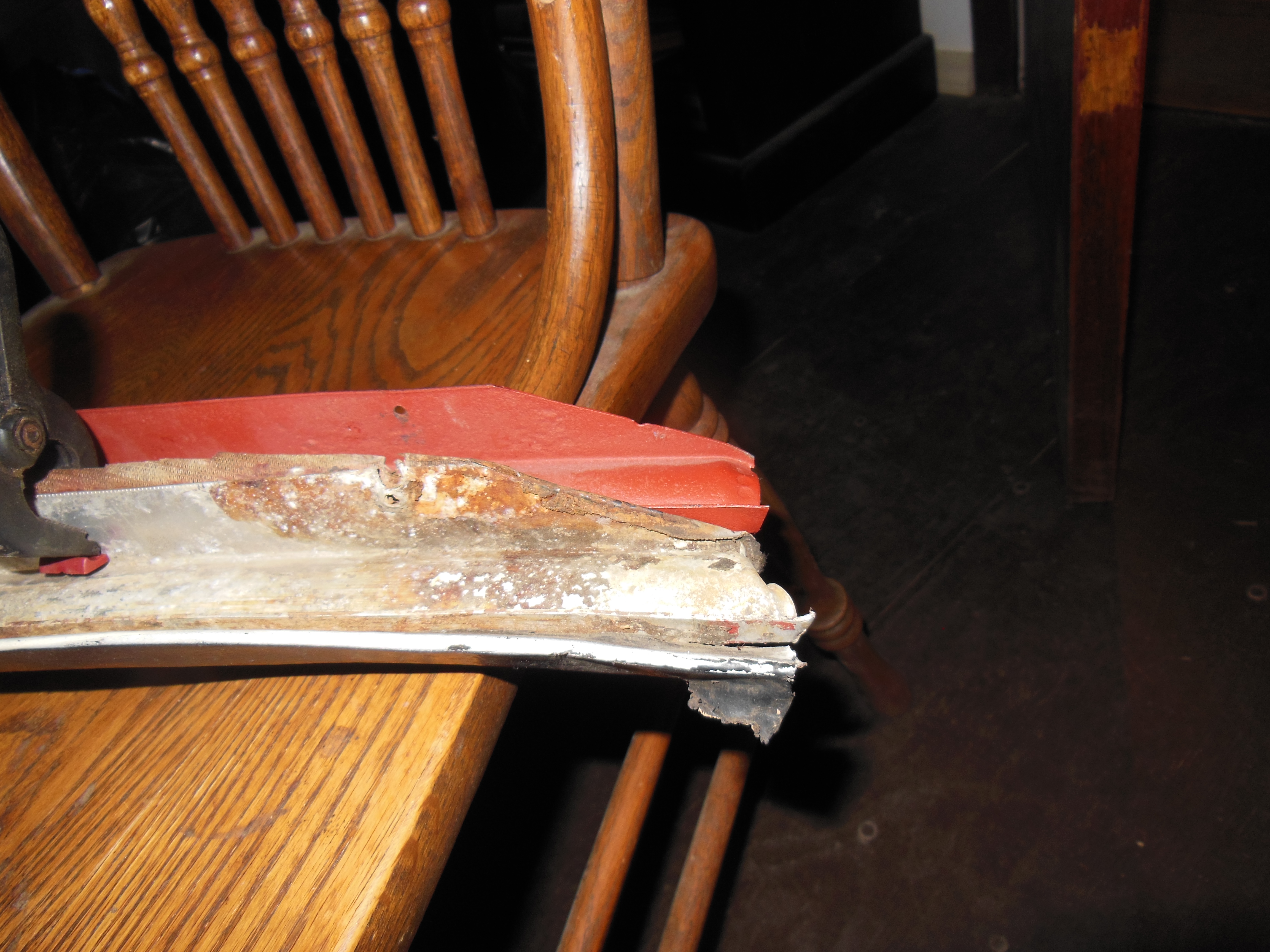

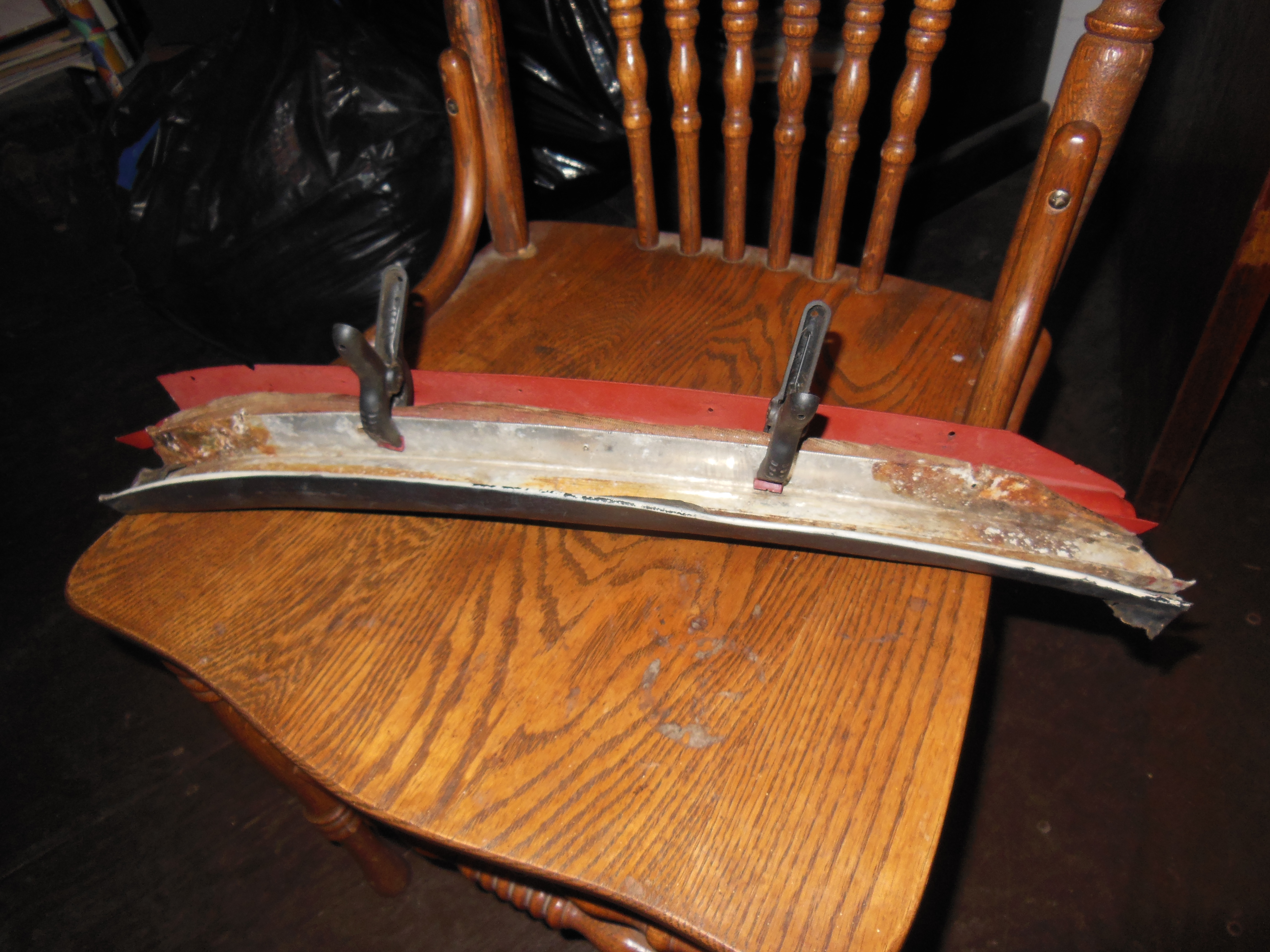

Has anyone seen these type door capping. They do not have the cup for the buttons and I am not sure if they are an aftermarket product or not. I talked to Marv and he has seen them, but does not have any. I would like to get one.

That's what I have on the TR2...I think it was for the wood topped doors and was tacked into place. Sorry, I don't have any extras.

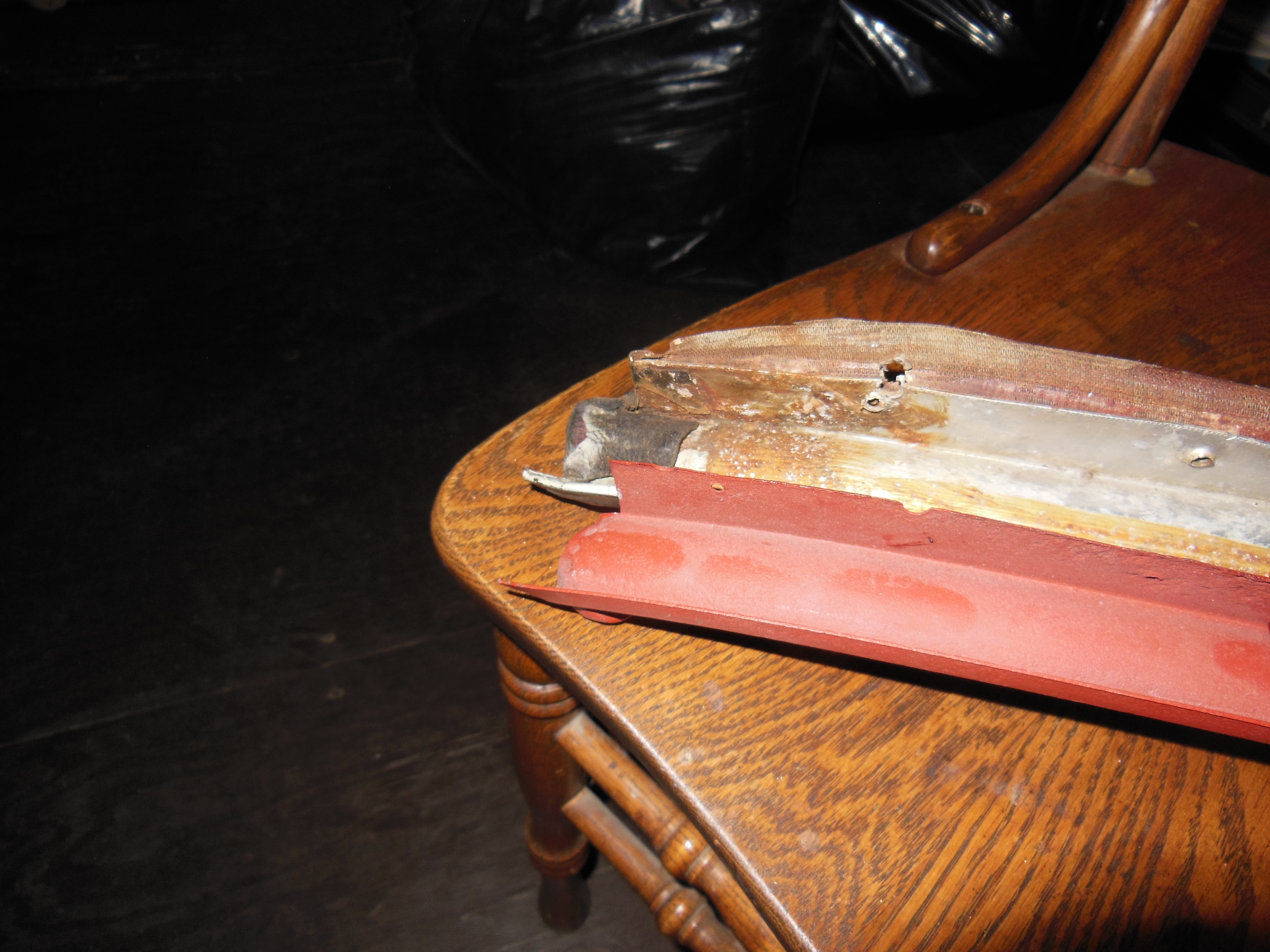

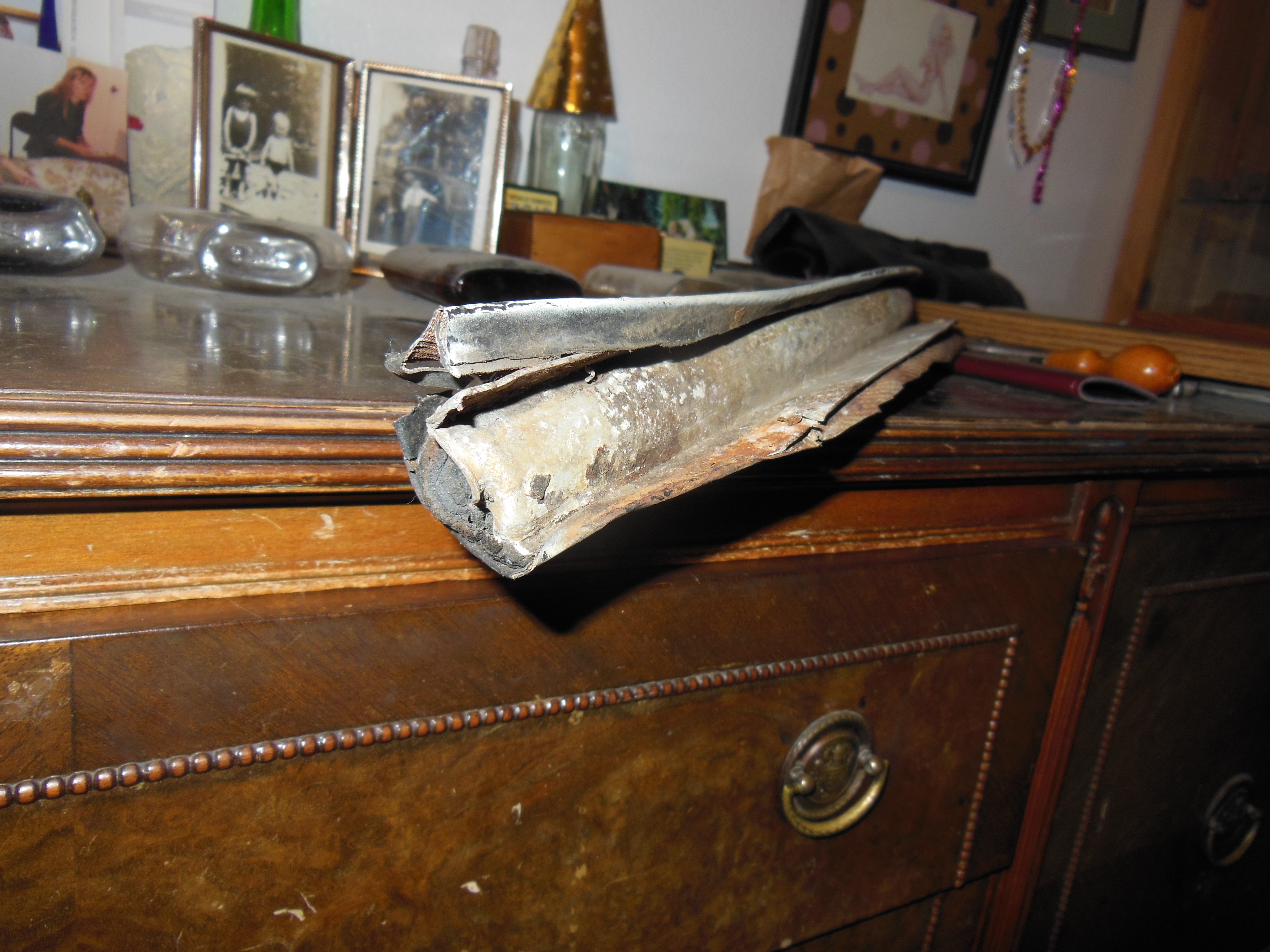

I took some pics from a tr2 and some from a 1958 tr3 and near as I can tell they are the same except for the end cap button.
