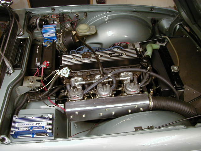

Here she is, after three months of heartache, finally back together. She runs, but only half-fast. Certainly some tuning issues but I think I should be on the road by Christmas. Improvements are: Triple ZS carbs (Gary Martin), triple intake, 1.55:1 roller rockers, GP2 cam, oil separator, solid steering rack brackets, aluminum shroud (all from Richard Good), reworked head with 9.5:1 compression and 3-angle port and polished with bench flowed intake (CDA Machine), Chromoly push rods, Kent adjustable cam sprocket and chain, new thrust washers, aluminum radiator (Ron Davis Racing), Sport Coil (Budweiser), 16" electric fan (Spal), fresh distributor (British Auto), aluminum water pump housing (Rimmer), steel front sealing block, no crank fan, new heater (me). I think I am burned out for awile. Anyone want to make an offer? (halfway kidding) I just have to adjust the gremlins out of her, gotta get used to the rougher idle with the fast street cam.

You guys are killing me!! Now I have an even bigger guilt complex over my lousy looking engine compartment. At least I can stall over the winter due to the freezing garage.
Seriously though, it looks great and I'm sure you'll have it tweaked in no time. Congrats!!!
vettedog72
I can’t believe you made it look better than it looked at the British Car Show in NO this past summer.
First, the reflection of the polished fan shroud makes me take a double take; gosh it looks good. The reflection of the plug wires on the valve cover is great. Now I know what the brake fluid reservoir is supposed to look like. Even the new electric fan can be seen by the new alternator. The coil and fuel pump appear new as well as the dizzy. Send a shot of the other side and include that water pump housing!

I really like the way that that aluminium shroud in there looks with the aluminium radiator. Please don't post any more pictures where it looks that nice, or I'll be forced to go do the same while it's out...
/ubbthreads/images/graemlins/wink.gif
Oh and is that the stock alternator? I never saw one that clean before.

Here's the other side. No, that is a Delco-style alternator conversion (66 amp). Here you can see the aluminum water pump housing. I also had my Falcon headers Jet Hot coated. I have to apologize, I haven't had a chance to detail the engine yet.

It's a thing of beauty Bill, now the real fun begins /ubbthreads/images/graemlins/grin.gif
As strange as it sounds it's a natural reaction to protect & preserve the hours of labor & sweat. Do your break in & treat her nice for at least five hundred miles while tuning & tweaking, then enjoy the fruits of your labor.
Truly a beatifull job , have fun.

That is awesome Bill! You have done an incredible job.
I am Laurel Green (or is it Emerald Green) with envy.
I am saving your pictures for inspiration for when I redo my engine.

Wow! That is simply beautiful Bill!! /ubbthreads/images/graemlins/ooo.gif

Now I have a model picture to take to the body shop that will be painting my fender wells and under bonnet to show them what I want to try to make it look like. Thanks for the posting.

I like the Christmas color scheme!

Would you please check the picture in the initial post? It's not displaying. The second one is fine. Or should I say FINE!!

Bob, the picture got deleted somehow. And I don't have it on my hard drive anymore. Sorry.

We should get more photos of tri-carb engine bays together. My engine bay is always getting complimented as well. Better get used to it. /ubbthreads/images/graemlins/grin.gif

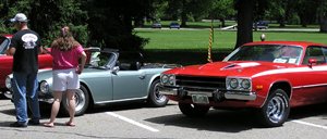

I've been thinking of colorkeying some items in the engine bay to match the body color. Pulling in some ideas from the hot rod crowd. Speaking of hot rods... many of the local hot rod/street machine clubs are more than accepting if I want to show my TR6 in their shows. (I'm even getting personal invites.) Most likely since it is a "Hot Rod TR6". I get nods and smiles when they hear the rumble (they know it's not a V8 but they like it anyway) and have even had crowds gather waiting for the bonnet to go up. Then they see the triple-carbs and they love it. Then of course the ribbing starts about how small the car is. When I get home I'll post a pic of my car at a local GTO club gathering. I'm parked next to an early seventies GTO and the little TR6 really looks little.

Bill, Here's the photo of my car at the GTO show. It's parked next to a '71 or '72 GTO. See the attachment.
