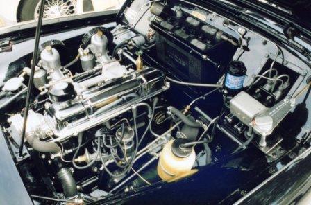

The throttle cross rod behind the engine on my black 1958 TR3A was black when new. It was (and is) body colour and black too. See photo you asked for from TS 27489 LO taken in 2007 when I was awarded 2nd in the "early TR3A class" at the VTR concours with 382 points out of 400.

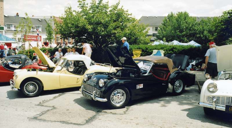

bnw & DON - The car had just been re-sprayed but the interior and the chrome front bumpers and bumperettes plus the stone guards were like new in 1990 when I finished my full body-off restoration. By 2007, these parts had a few sandy chips on them to take a bit of the shine off the surfaces. The patina on the interior must have lost me a few of those points having been driven over 94,000 miles between 1990 and 2007. I also seem to remember losing a point because the judges saw smudges of fingerprints on the 18 year old vinyl windows of the ragtop.
