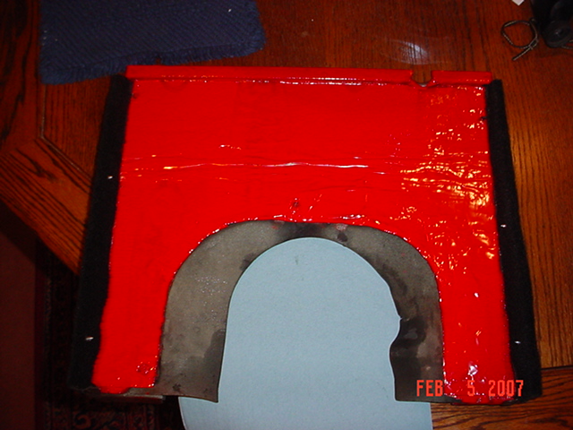

Hi John,
My BN2 still has the original seal/heat deflector. You can see it here as iitem 7. Although listed as NA.
https://www.mossmotors.com/Shop/ViewProducts.aspx?PlateIndexID=28963&SortOrder=9
As to how well it works, It DOES keep the engine & exhaust heat from fflowing back into the transmission tunnel. It might actually make the transmission cooler since the engine & exhaust heat which is far hotter tthan the transmission is somewhat blocked.
Basically it is a rubber flap about 1/4" thick that is riveted to the extension panel & fits snugly around the front of the transmission.
Attached is a pic of the panel & seal viewed from the engine side.
D

Hi Dave,
Thanks for the photo and description. Maybe this was one of those items they wanted to add to the 6 cylinder with the introduction of the BJ7 but was crossed off the list? I'll dig around some more ...
