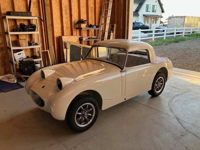

I need to replace the windshield -> car rubber seal on the Bugeye in order to get it mounted back on the car for shipping. I've got a new seal in hand, but I've not done this one before. Do I need to remove one/both of the stanchions in order to slide on the new rubber, or is there another approach?

Thanks for the tips all. My wife and I (I owe her now) got the rubber installed and the windshield on the car tonight. Took off one of the stanchions and the new rubber slipped right in. Used some soap and a bit of twine and it's all on the car.
Funny, the pic looks like I just need one good weekend push to finish it off. If only. ;)
Congratulations.Glad it went smoothly. Looks like you are just about "there."
