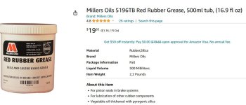

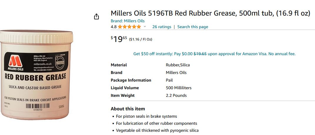

I have used Miller Red Rubber Grease with conventional Dot 3 and 4 brake fluid, and use Silicon grease with Dot 5. Most red rubber grease formulations have additives to increase their resistance to oxidation and corrosion (as is specified in Girling TS-2_34_04).
The Miller's is Castor based:
  • For piston seals in brake systems
  • For lubrication of other rubber components
  • Vegetable oil thickened with pyrogenic silica

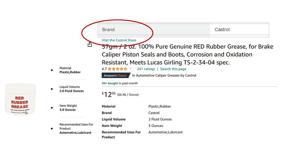

If you are not comfortable with Millers (slide 2 and 3), as you said Castrol brand Red Rubber Grease is available (slide 3). It states it meets Lucas Girling TS-2-34-04 specifications (corrosion oxidation resistant) and claims to be the original formula. I would think it is a good product.
