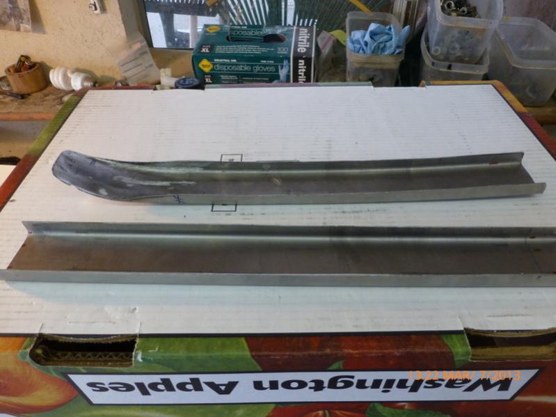

I used fender patches from Moss, but didn't use the whole section. The repair patches are flat the whole way up and the fender (wing) isn't. The bottom section of the wing is pretty flat, so I just used enough of the patch panel to repair the rusted bottom of the wing. I re-flanged the panel using one of those cheap pneumatic flangers from Harbor Freight. It worked very well. I spot welded along the flange, then seam welded it and finally leaded the seam over. It turned out fine. I was going to butt weld the sections together, but decided to go the flange route, as it I thought would probably yield a panel that wouldn't get so messed up from too much heat.
I used the flanging tool for several other panels that I had to make.

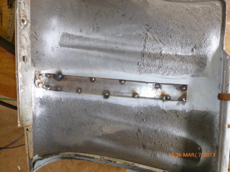

I used some scrap sheet steel and the HF pneumatic flange and punch tool. Worked great. But installing a patch panel on a large relatively flat surface is not that easy. You fit the panel, punch it, plug weld the flange, and then seam weld it. The heat of the seam weld causes the metal to shrink along the seam, which will "oil can" your fender and create some new metal work challenges. The real pros will butt weld the panels. Then, they can clean up the welded area with a grinder and use a hammer/dolly to stretch the welded seam, removing the shrinkage that is unavoidable with the seam weld. You can't easily clean up a lap weld (flange) with a grinder and hammer/dolly the double thick welded seam. You'd have to hit it long and hard to stretch that area. I can write a personal testimonial on this subject.

Here is a photo of a flanged patch panel with MIG seam weld and significant shrinkage on the seam. All the spots are where I shrunk the metal to remove the oil can problem. (think of the bottom of an old style oil can, where the bottom will push in and then pop back out). This worked out well - I used a stud welder to shrink the panel.
