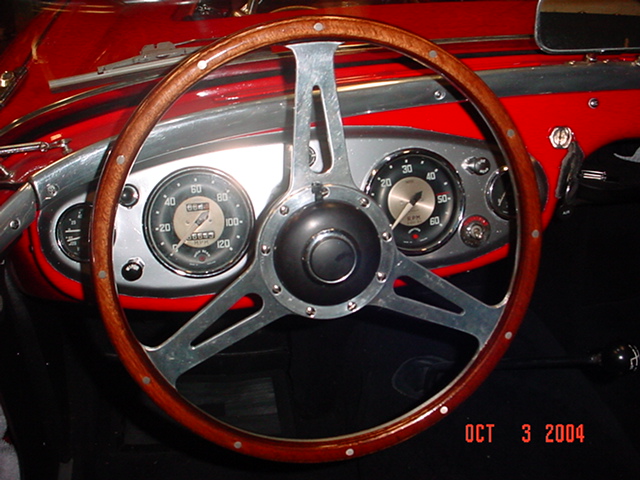

In restoring my 100 "M" BN2 and is going to paint the instrument panel. The raised instrument facia is going to be painted as original "light nonreflective silver". Can someone help me with a paint code for this !

Hi Peter,
Welcome to the forum,
After all these years, it's hard to know what they meant by "light non-reflective silver". I went through several tries on my BN2. I tried a number of aluminum, dull aluminum, & silver, brands & colors. A truly dull silver finish shows all dirt, scuff marks, & any attempt to clean it shows color/texture changes. Any cleaners, chemicals on it will cause a color change. Not practical at all.
I settled on an aluminum base coat topped with a satin clear. It looks pretty good & can be cleaned without color/texture changes. Don't know if it matches original factory or not.
What ever you use, experiment on another piece of metal first until you find what you want. I found that "some" aluminum paints darkened irregularly when topped with clear coat. I can't stress this too much. The alternative is to strip the dash & start over. I've done it.
Don't know what is available to you. I ended up with "Krylon Dull Aluminum" topped with "Krylon Satin Clear" top coat. Spray the top coats very dry & light. About 14 inches distance. With this combination, the base color did not change at all & it seals the aluminum so that it doesn't discolor when cleaned.
When masking the area to be painted, use a thin & narrow vinyl masking tape to get the initial outline. The 3M blue type, 1/4" wide.
A pic is attached.
Maybe someone will suggest an easier method
D
