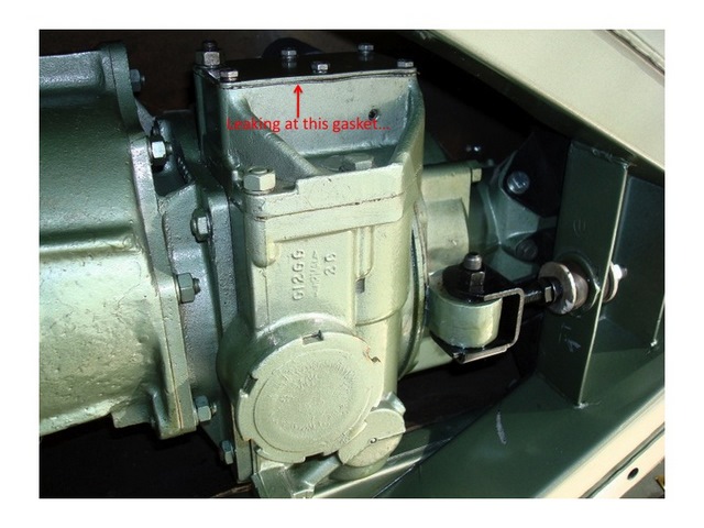

I was finally able to take a picture of the plate, gasket that is leaking. So to clarify, can I remove this plate and replace the gasket? Or is it good that its leaking so the solenoid doesn't malfunction?
Thanks,
Bob

Keoke
NO!!!, if you have a leak there you most likely have a defective "O" ring and it must be replaced.
There is the remote possibility that a leak at the top of the rear solenoid bracket gasket is alowing oil into the cavity but I doubt that. :nonod:---Keoke- :driving:
Or is it good that its leaking so the solenoid doesn't malfunction?----NO
