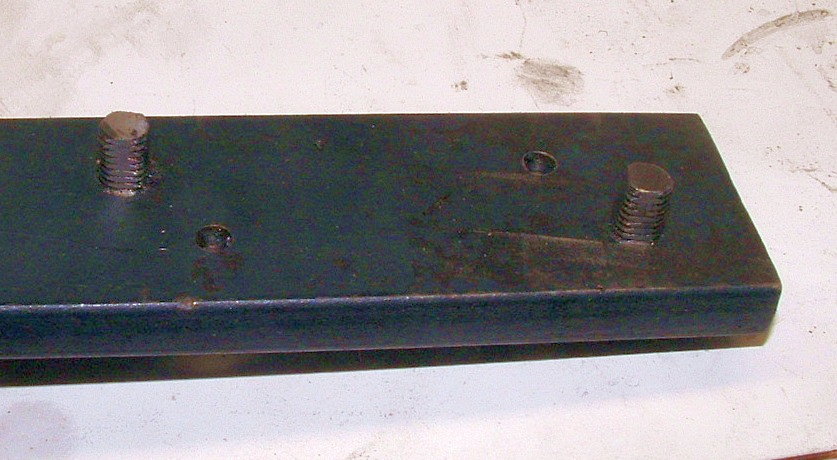

Here's a simple tool I made in about 20 minutes:

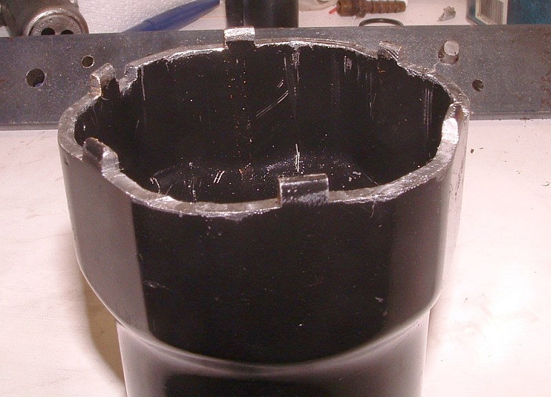

And a fancier one where I bought a big socket on eBay (about $10 IIRC) and milled some teeth into it.

I could try making that tool.
Those bolts are filed flat so they fit tight in each notch, correct?
And you turn the steel plank (or plate) by hand, or just tap that with a hammer or drift instead?
Correct. 5/16" bolts, filed down to roughly 1/4" square.
<div class="ubbcode-block"><div class="ubbcode-header">Quote:]
And you turn the steel plank (or plate) by hand, or just tap that with a hammer or drift instead? [/QUOTE]
It's just a bar, about 18" long. Maybe 3/8" thick by 1-1/2" wide. Started life as a post for concrete forms at Home Depot (which explains the extra holes). The other end is a similar "quick and dirty" tool for unscrewing the plugs in the bottom of a J-type OD.
I used it by hand, but you could tap on it if needed, for some extra torque.
