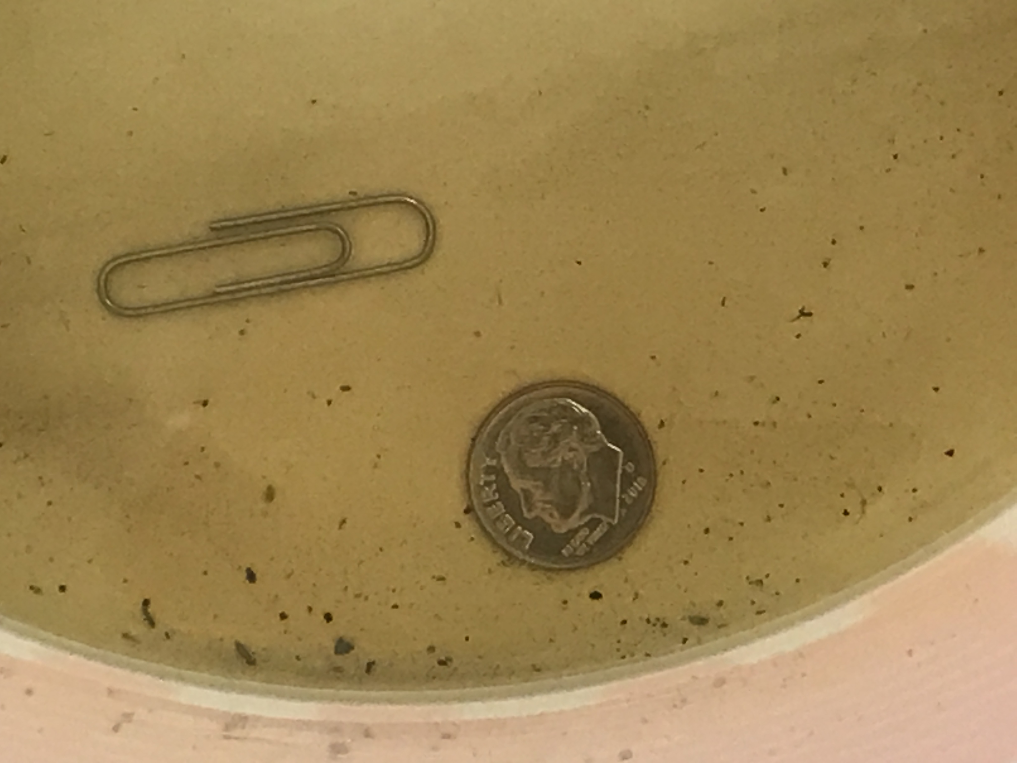

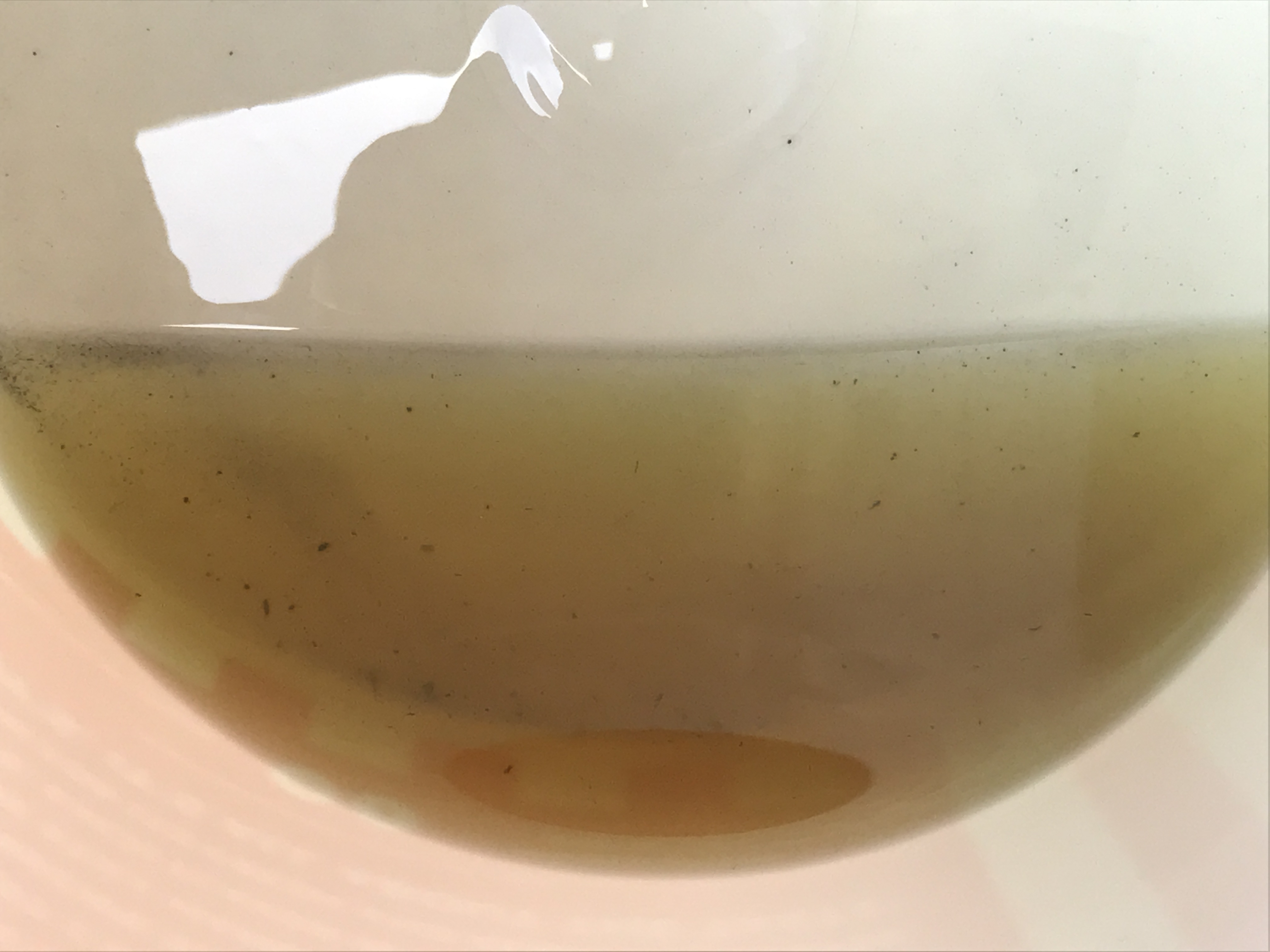

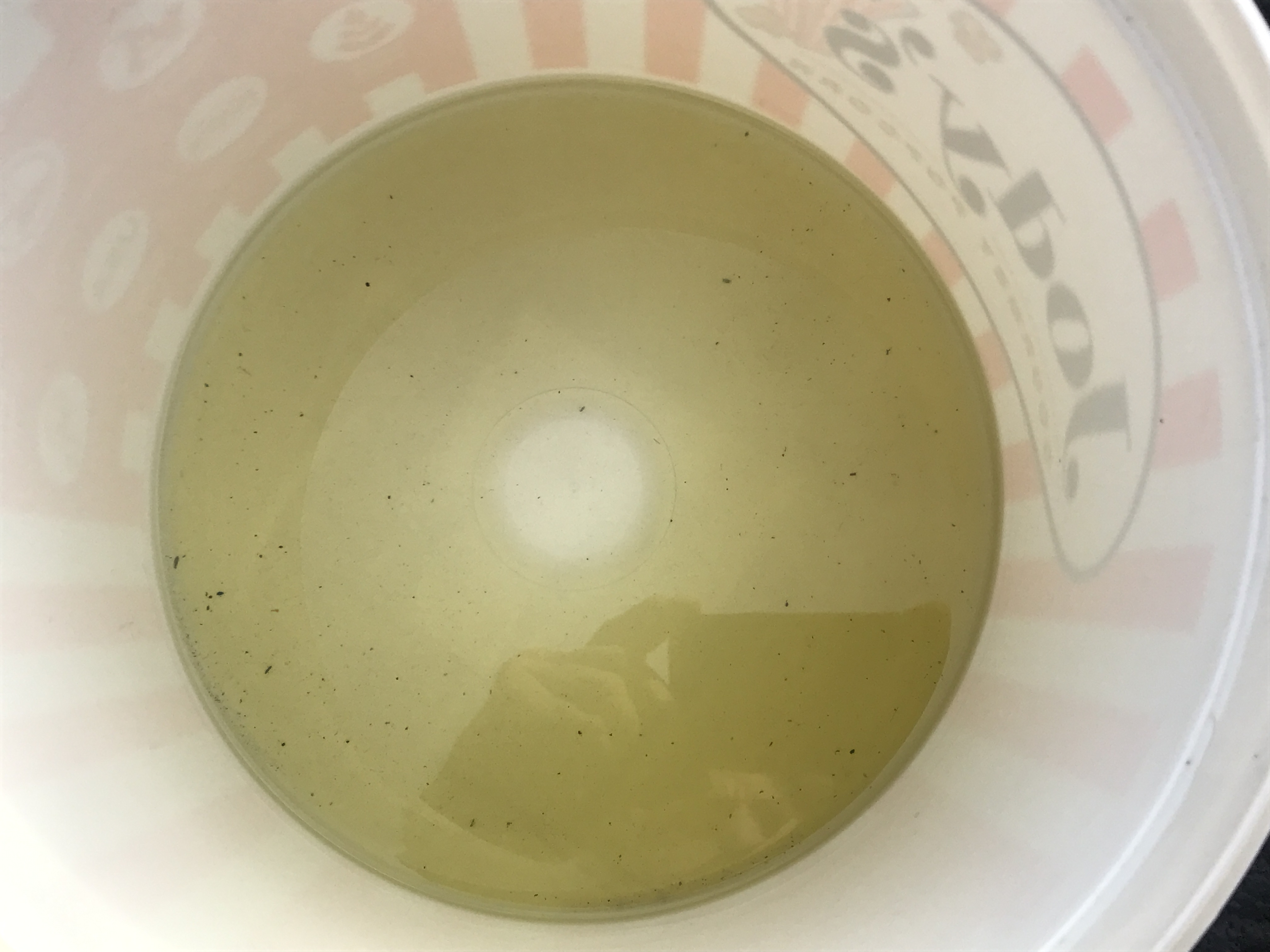

These 3 photos are of the same drain, same amount of oil in the bucket. Thought on the debris?
Now I'm confused; you said: "The OD was working, so I didn't open it up;" was all the work on the O/D you mentioned done before the gearbox rebuild, or did you pull it out again? At any rate, with a functioning pump but no pressure the most likely culprit is the ball-bearing check valve on the pump output. I believe it's possible to get to it in situ, but I've not done it so can't help. IIRC, someone on this forum has described how to do it.
Hey Bob, thanks for your help. Sorry, not intending on confusing anyone. While the tranny work was being done, the OD has to be removed. I replace all the rubber items in the OD I can get to without taking the entire OD apart. The OD pump can be removed from the bottom, you don't need to open it up.

Update. R&R the pump, now have 510 psi. As suspected, the roller was not on the cam. OD is working after adjustment. Flushed the tranny/OD with 30w oil two times, 15 min run time in gear, while on jack stands. Oil now seems clean. I'll drive it for a little while and drain it to see if it's debris free. Thank you for your input Bob and Healey Nut.
