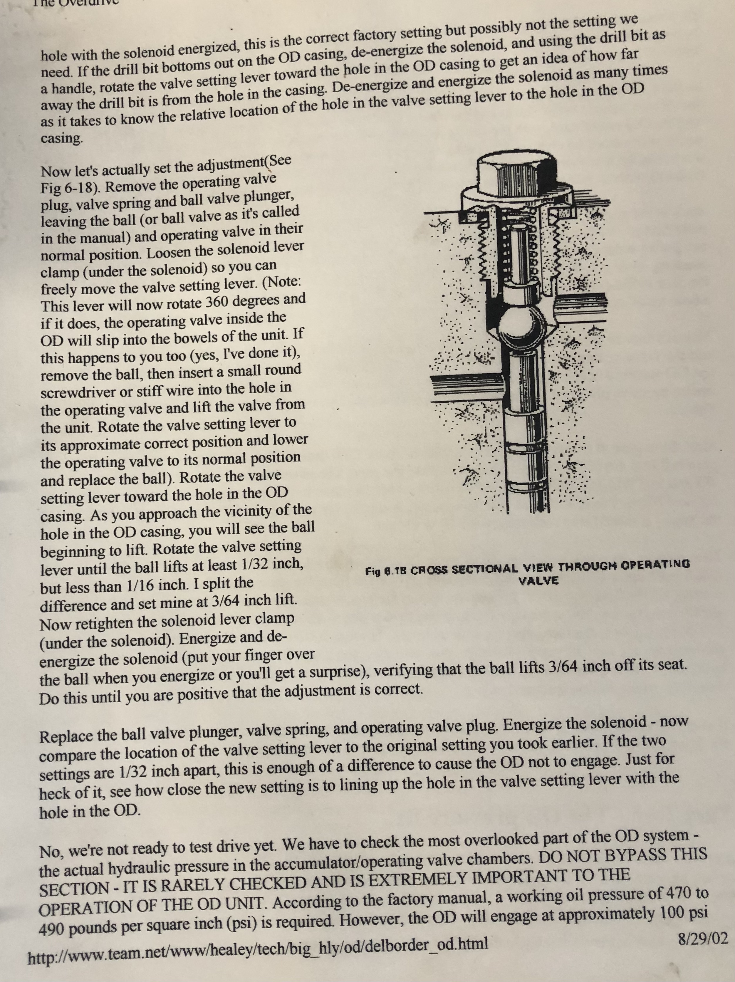

Hi all. I've run into an unexpected issue. My overdrive in the BJ8 started not to engage after about 20 minutes of driving. Since the unit was supposably rebuilt a few years back and had been working fine, I suspected the solenoid and, indeed, it could be part of the problem. But I also put a pressure gage on the control valve and found oil pressure to be ~455 psi.
This is new to me and I'd like some advice on:
1. Is this a pressure that can cause my issue? and
2. What can I do to fix it?
I know there's a lot of resources about this, but I haven't found anything that says what pressure is the minimum needed to function.
Thanks.
