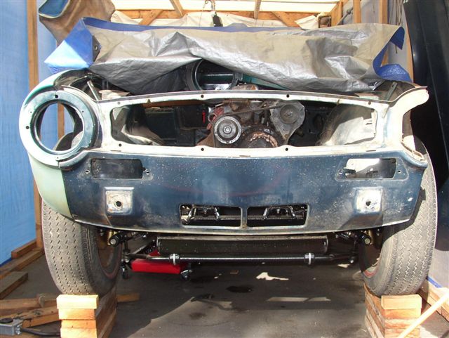

Here is a picture of my original 73 TR6 front end. The fender in this picture is a replacement part from about 10 years ago. You will notice that the fender sits a little high. On my project, this is due to the top flange on the fender being slightly deeper then the original, but something I can easily work with.
There was a change in fenders at the 74 1/2 model year. I believe as you stated it should only have impacted bumper mountings.
You may be working with problems fixed by the previous repairs. That is to say, who knows what they did to make things fit.
Hope this helps.
Ray
