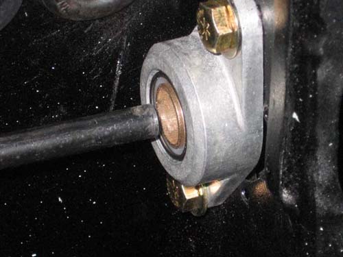

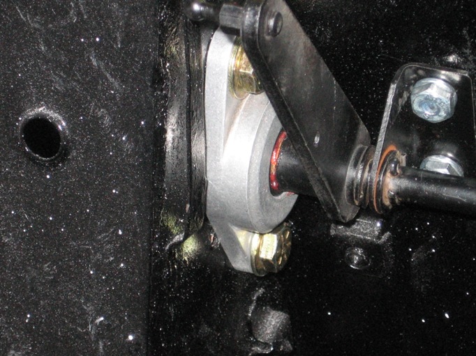

Of course, I guess that's not so little. So, another mod that I did while the resto was going on was to address the throttle linkage. I replaced the original bulkhead pivots with self aligning bearings that can be changed out very easily if necessary.
Those are nice. Mind sharing where you got them?
I got them from McMaster-Carr. The link below shows the type bearings I used. You have to go to the "Oil-embedded mounted sleeve bearings with two bolt flange". I used the 3/8" shaft diameter for the right (passenger) side, which is the diameter of the actuating rod, and 1/2" for the left (driver) side. The reason for the larger size on the driver's side is for the coupler that I made. You can see that in the second pic of the previous post. It's 5/8" with a step down to 1/2" where it goes into the bearing. You can also see where the pin holding it together in that coupler. Also, here's another pic of the left side without the coupler.
EDIT: Please see post #22 if you are considering this modification.
I just ordered both bearings. Thanks! Were you able to mount them in the existing mounting holes?
