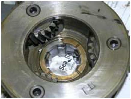

Here's a shot of (part of) that washer in situ (taken from the article on the VTR website by Sam Clark & Larry Young). They do frequently break (I just replaced mine earlier this year).
What I found on my OD was that the end float was way higher than specified, even with all new thrust washers and the thickest available shims. I note that Sam & Larry found the same thing (broken washer plus too much end float). I have a suspicion that everyone is doing as they did and leaving it too large (or as I have done in the past and just not checked it at all :smile: ).
My theory is that the excess end float is what causes the thrust washer to break, because when you switch out of overdrive, the sun gear gets thrust to the rear by the motion of the clutch, and the excess clearance lets it slam into that thrust washer. I think the breakage will stop if the clearance is brought within spec (which for me required machining an additional spacer washer).
But that is just a theory at this point, ask me again in another 10 years :laugh:

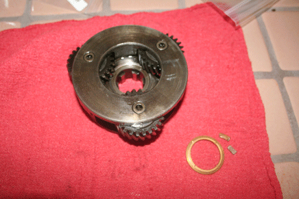

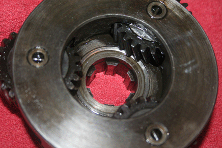

Here is a picture of my planet gear assembly with no thrust washer. So--where is it? Do I need to go searching thru the transmission now for chips and slivers?
Am I OK to drop a new one in after working out the Mills pin, etc.
If if comes thru, you'll also see the chips I found plus a new thrust washer for comparison.

Looks to me like it would probably be OK to just install a new one. The shaft will hold it in place even if the pocket doesn't; and if the surface is a bit rough then it will just turn with the carrier instead of with the sun gear (when in overdrive). But I am just guessing and hoping, since mine looks very similar and that is what I did.
I do suggest checking the end float and being sure to bring it within spec. You may need more spacers if some of the carrier is worn away.
Also check that the end of the sun gear is still reasonably flat where it will contact the thrust washer. If it is worn to a funny shape from hitting the carrier, you may need to dress it down or replace it. And I believe the book says the annulus, sun gear and planetary gears should all be replaced as a set.

Useless bit of trivia to add: the first picture Randall added is for a 28% gear set probably from a Healey. You can see that the planetary gears are slightly smaller than the gears in the 22% gear set in the second set of pictures. The nice benefit of the 28% set up is that the thrust washer doesn't interfere with the gears and can be changed easily.
