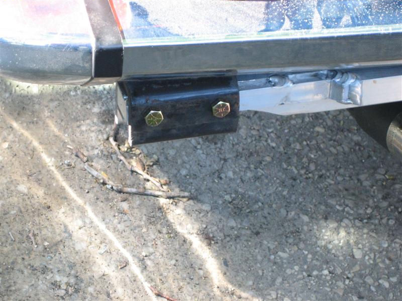

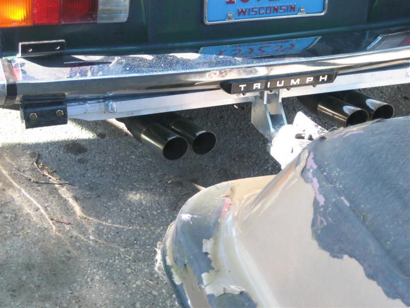

As already stated the front left the holes which I left for possible future driving lights. The rear brackets are perfect for a mounting place for a trailer hitch. When I installed them after painting the car I cut off the "horns" sticking up making a cleaner look.

The rear needs a 1/4" thick spacer between the body and bumper. I had some pieces of scrap steel, but aluminum would be better. I used 3/8"-24 x 1-1/4" bolts here with a long extension socket with a wobbly end. Bumper was supported by 3 jack stands when I undid the side bolts and removed the original ugly bumper support brackets. it's a good idea to completely remove the bumper in order to clean up the captive nuts for easy installation.

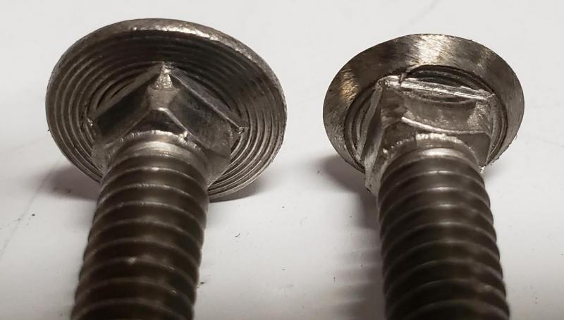

For the front holes, on eBay, bought a 10-pack of 1/4-20 x 4-1/2" stainless carriage bolts. Turned them down to fit on my drill press with my HF hand grinder. Cut them off to 4-1/4" and buffed the heads.
