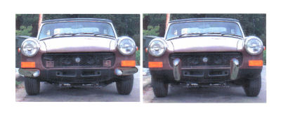

Removed Frank's bumpers today!!
RickB
I just knew he would look better this way, I'm already pleased even though I don't have a new grille yet or any bumperettes.

I know, that heavy bumper really weighed the front down!
WOW! It's like 6 inches higher than it was before!
I think part of it is the black valance. I think that if I painted it brown it wouldn't look so high.
racingenglishcars
Yeah, you're right. Paint the valance brown and the bumper mount flanges black. It will give a whole different look.
Then drop the front by a couple inches. I think there are spring spacers above the springs. A one inch spacer will raise the front by two inches.
As with all rubber bumper cars, the rear body was flattened under the tail lights. A filler piece would look good there. Even a glued-on piece of plastic with the right shape and painted brown would look nice enough. Or weld in some metal.

You can always cut those huge front bumper brackets off & use an early grille...here's an example of how I cut them from my '79 MGB:
& test fitting an old grille:
All I had to do afterwards was clean the cuts & weld blanking plates over the open ends.
& the rear piece under the taillight is also an easy modification.

I'm converting mine to a chrome bumper so I too have the "cut off" back under the tailights. My dubious advantage here is that the car was rearended so I just bought a pre '74 valance to replace the existing one. Still, I've been thinking for some time whether a pair of bumperettes could be adapted to sit right under the taillights. Kind of like the back end of a '54 corvette.
what thinkest the group?
Since you are going to be replacing the roll pan I'd go ahead and fab up some filler bits for the blanks under the tail lights.

I have thought of that also, and I for one think it would work and look quite nice!! I have also considered using the rear BE bumperettes on the front as well!!
PS Frank DEFINITLY need to have the suspension lowered!!!!
And lowering the front suspension only requires a trip to the hardware store! ...more or less.
bugimike
I took the liberty of playing with your pics to see how bumperettes would look! Tried it two ways... /bcforum/images/%%GRAEMLIN_URL%%/grin.gif
PS also took the liberty of "lowering" the suspension!!

Hmmm, are they a secret? See em now. Noop. Too heavy for the front end, need to be much thiner.
How about the fiberglass front and rear spoiler thingees, they look real nice.
bugimike
Jack, some of that "heaviness" could be due to my "grafting skills", or lack thereof! I am not sure they are scaled "just right", and the angles they are mounted at could be a bit off too (I just "stole" the bumperettes off that new BE that was posted recently!) /bcforum/images/%%GRAEMLIN_URL%%/thumbsup.gif

Seems to me that it would look better with mounts and driveing lights or nerf bars kind of.

I've got a grille I plan on sniping at the last moment on Ebay right now. Whether I use it complete or just the surround bits and then a vertical slotted grille I don't know yet. I've found some available parts.
Yes, the exhaust has to be changed asap. Now that I have a welder I can get that part done better.
What's the "trip to the hardware store" for - what do I need from there to lower the suspension? Where are the spacers located and what do I need to take apart to get to them?
(the hardware store is literally across the street a half a block away)
I have some spare MGC overiders here, I was going to look at them and see how they look maybe as back bumperettes. Thoughts?
