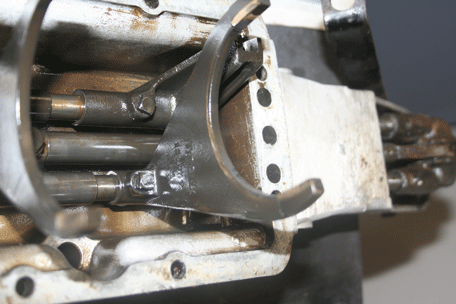

A very interesting discovery. Contrary to better advice, I did take apart my transmission cover, and I did snap off the first of the three tapered setscrews in the shafts. Old subject by now.
See pic below (before the break).
My machine shop was ready to try the next two tapered setscrews when a Jaguar guy stopped in with another issue and saw my cover sitting on the bench with the snapped setscrew.
He said that he'd been told that those tapered setscrews should be removed with an impact driver connected to a socket--not air controlled, but one you hit.
The shop tried it on the other two, and each tapered setscrew was easily removed with no damage. Basically, I'm done and ready now to reassemble.
Just wanted to pass that info along and record that experience here for the next person tackling a transmission and learning as they go. Maybe a coincidence, but my guess is that the hitting/vibration/shock of an impact driver enabled the setscrews to be removed.
