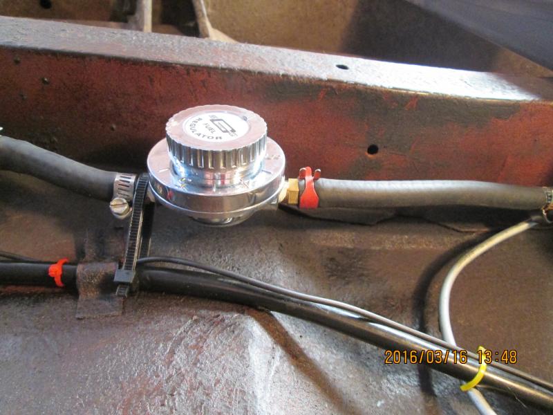

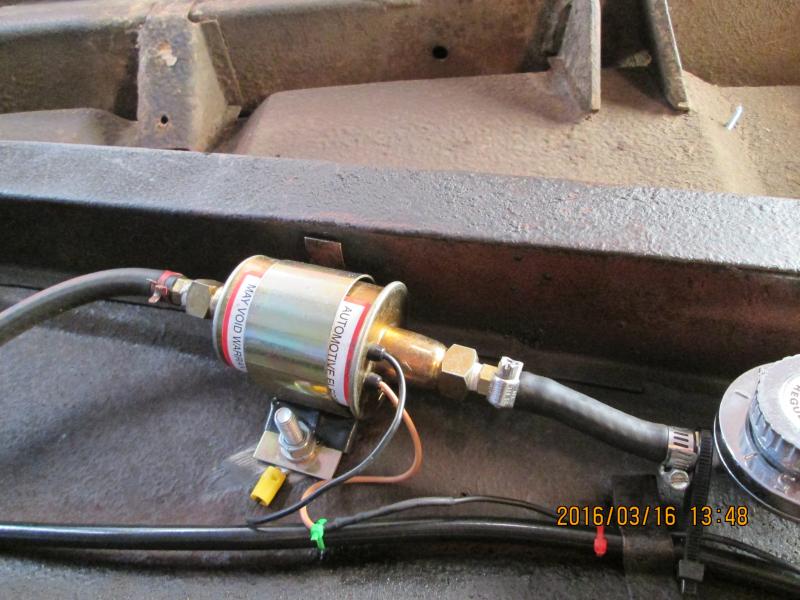

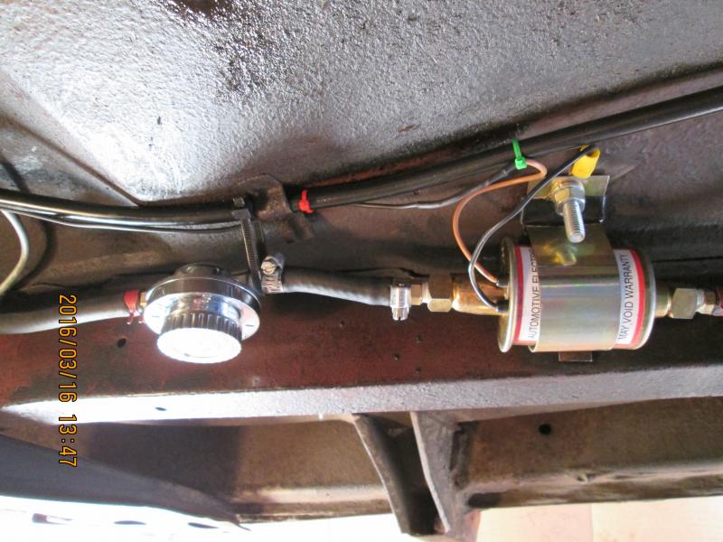

I've installed "Airtex E8016s" on 5 British cars over the past 10 years--also A "MR Gasket" fuel pressure regulater--negative ground--easy installation--
Have also used this,same as above, aftermarket fuel pump\Spectra E8016S\SP8016U(Autozone Lifetime) since 2005. No regulator. First one went bad. Autozone replaced and has been trouble free many years. I do carry a spare. Easily switched if necessary. Ticks away like SU.

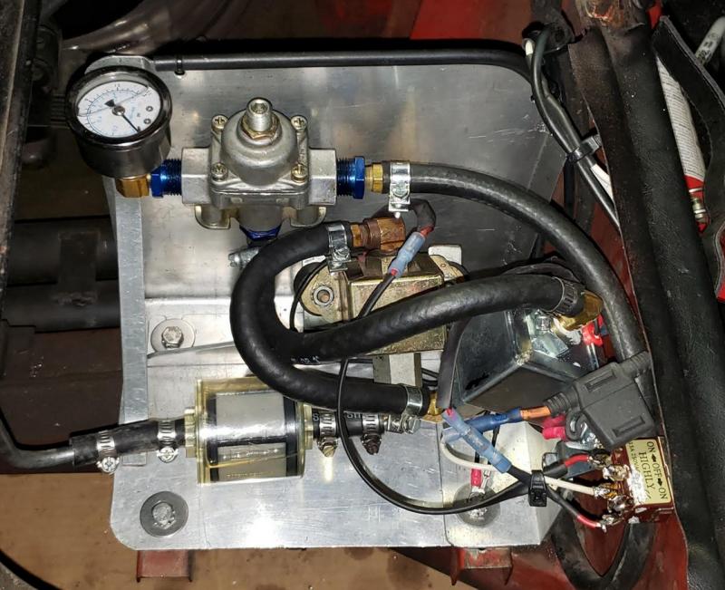

steveg
....which I simply find philosophically preferable....
It comes down to this - ultimately, the cars are performance art. :smile:
I mounted mine in series with an on1-off-on2 switch - works as advertised.
With both mounted on rubber isolation mounts, the ticking is only audible with the engine off. Have lately moved the fuse to the bottom slot on the Charlie Hart fuse box.
