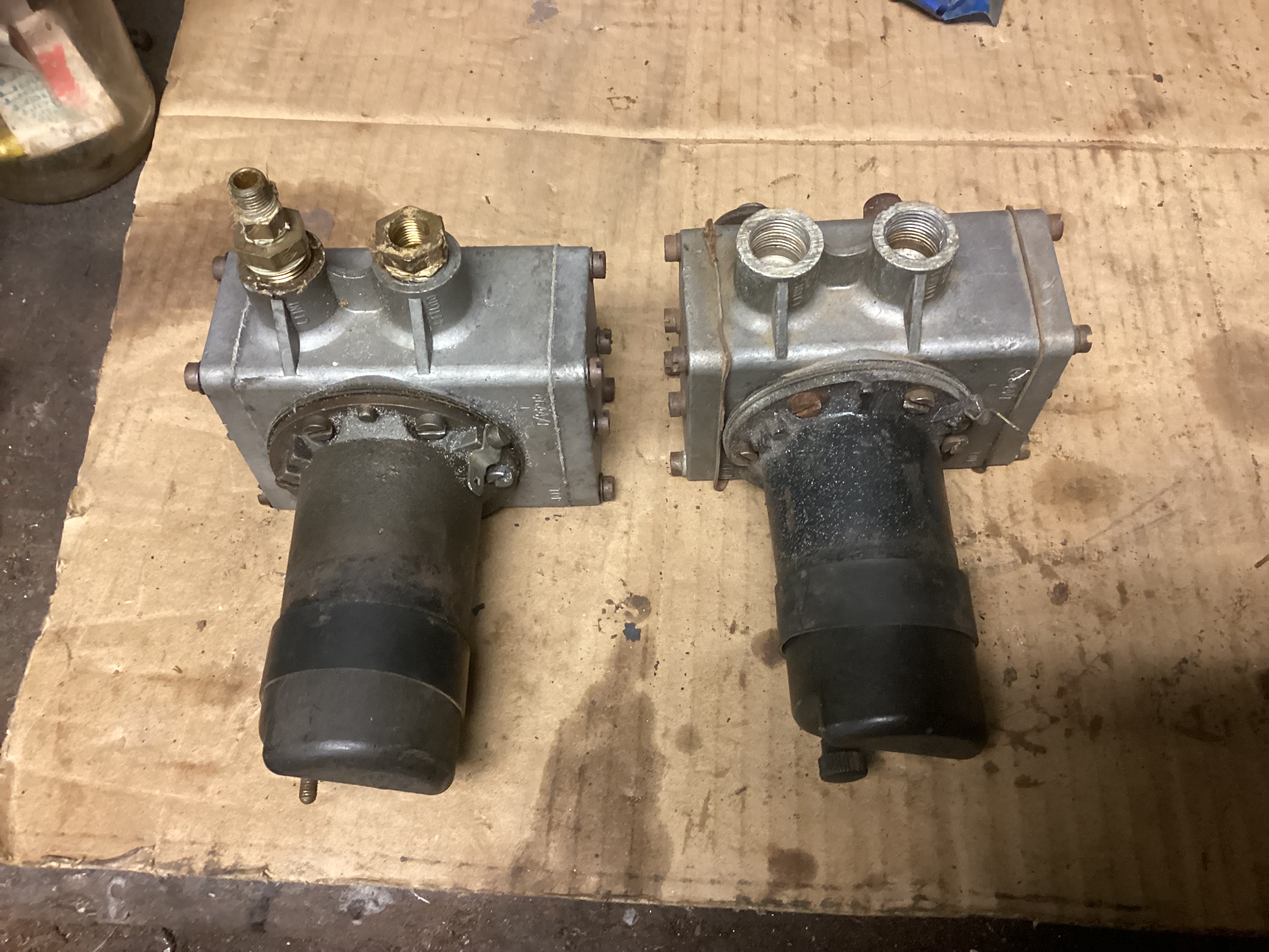

I have two Working Sq body pumps. $100 and shipping for either one

Marvin, it looks exactly the same from the outside. The exception is starting sometime in the 1960's Hardi switched from a black cap to a clear cap.
On the inside all the screw threads are metric and it is much easier to get stainless cheese head screws in metric. The SU pumps used the funky 2BA threads which you can't find stainless or even zinc plated in cheese head. The points look identical but are not interchangeable. Since the diaphragm threaded rod is metric, the std SU points cannot be used unless you swap some of the parts around. The Hardi points have a much better (simpler) way of adjusting the gap. Also, a biggie is the brass check valve design. Almost looks identical, but Hardi added a small spring and cover to the outlet valve to ensure it closes. The die cast end covers and the sand cast body have much better surface finishes inside and out on the Hardi.
I have two Hardi square body pumps, one dated 1958 and the other 1970. The 1958 one has a black cap while the 1970 has a clear cap. Otherwise identical.

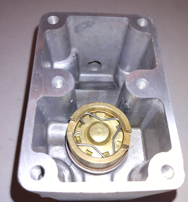

This first pic shows the Hardi valve assembly. The domed disc has a small spring underneath pushing down on the normal outlet brass valve disc. The main valve housing is basically identical to the SU but has been machined deeper to account for the additional domed disc.
There is also the normal brass disc and larger spring below the valve creating the inlet valve.

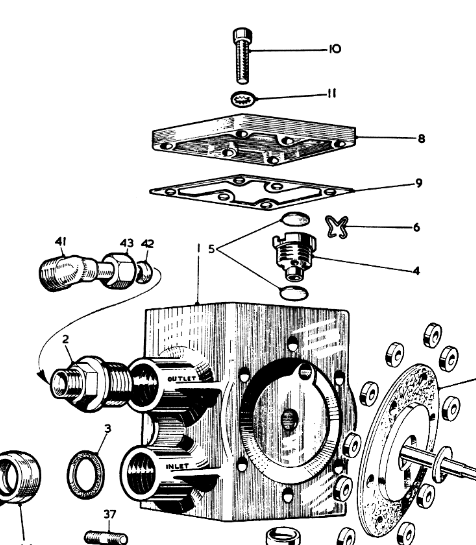

Here is a pic from the Healey BT7 parts manual showing no springs exist on the SU pump.
