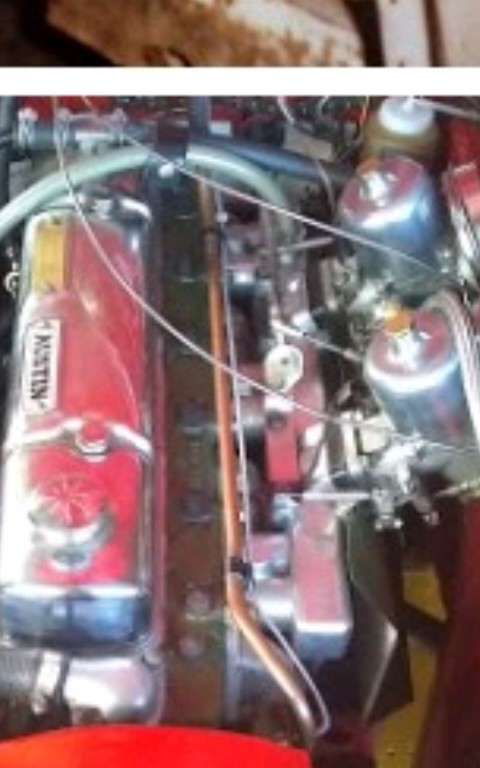

Thank you so much..... I was of course getting the usual 18 mpg before covid lockdown anyway, but it's a long time since I have been able to go out for a long journey☹️and all I do is play in the garage. Mind you, she is looking better than ever.
