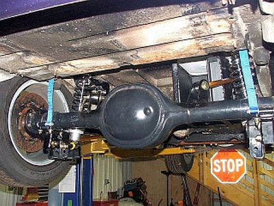

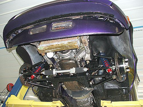

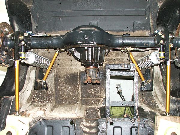

That being said, I have a FastCars, Inc front crossmember and a Classic Conversions four-link rear suspension on my V8 conversion.
Neither of these suspensions could be considered "inexpensive", but they do in fact "add something" to the performance of the car.

Rick, what rear end do you have in there, a Ford?
Yes, 8" Ford with an Auburn 3.27 posi.
