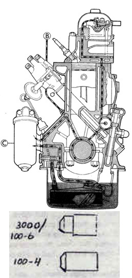

The possibilities are:
1- Someone has changed or shimmed the relief valve spring for more tension.
2- The spring is binding inside the relief valve plunger.
3- Related - the plunger is not moving back far enough to uncover the relief port, or the wrong plunger is installed. The Fours & the Sixes use a different plunger.
4- The plunger is still binding, although you checked it.
5- The passage from the pump to the relief valve is restricted/plugged.
6- The passage from the relief valve port back to the sump is restricted/plugged.
See attached pic of the oil flow.
A remote possibility is that the oil pressure gage itself is sticking at full pressure. My gage does this occasionaly. Simply moving the hard line on the back of the gage very slightly unsticks it.

The oil pressure gage take off is down stream from the relief valve & the filter. A plugged filter would have caused the gage to read very low. If I could get the above mentioned pic to you, you would be able to see immediately how it works.
