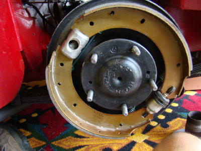

Thanks Lin, that does give me an idea though. Looking back through my records I don't see any MC purchases listed, or even rebuild kits. So, it's possible I didn't do anything to the MC. I don't know why but the front brakes aren't affected and work fine. Again I pulled the rear hubs off and checked the springs. Strangely, the manual ( in the MMM)section call for two types of springs the shorter spring should go near the brake adjuster. MOSS lists only one type of spring and you'll need 4, that's what I have 4 springs all the same size. I'm really beginning to think the MC is at fault.
GregW
Platinum
Re: What does "excessive brake fluid pressure" mean?
Hi Johnny,
Looks to me like one of your shoes is installed backwards. That looks like the left side brake. So the shoe on the left in the photo should be flipped so the leading edge is at the adjuster. The leading edges on the other side of the car will be mirrored as you sit looking at the assembly.
