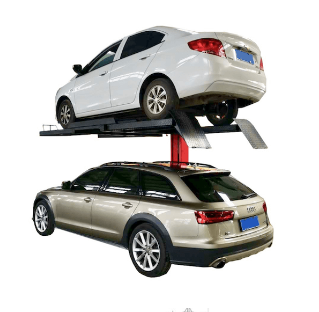

This is my dream but cheap it ain't - last time I asked about 6k so double a regular lift
when I went to get the picture above I saw this also, I suspect not cheap either
Just had a look at their web-page: when the web-page says 'call for pricing', I tend to figure it's way too pricy.
I just looked at the 2017 price list - that lift isn't mentioned and they are priced competatively for the regular lifts - the do have some chinese parts but seem to have CDN & USA parts as well and presumably stand behind their project.
If you go to the website, they do have a location in Calgary FWIW

Finally got off my butt and phoned the local distributor for the Park Magic Single Post Lift and - $ 13,000 Cdn. The model is being discontinued and he hasn't asked for quotes for quite some time as no one wanted to spend that kind of money. Doug
see if he has any in stock that are deeply discounted
