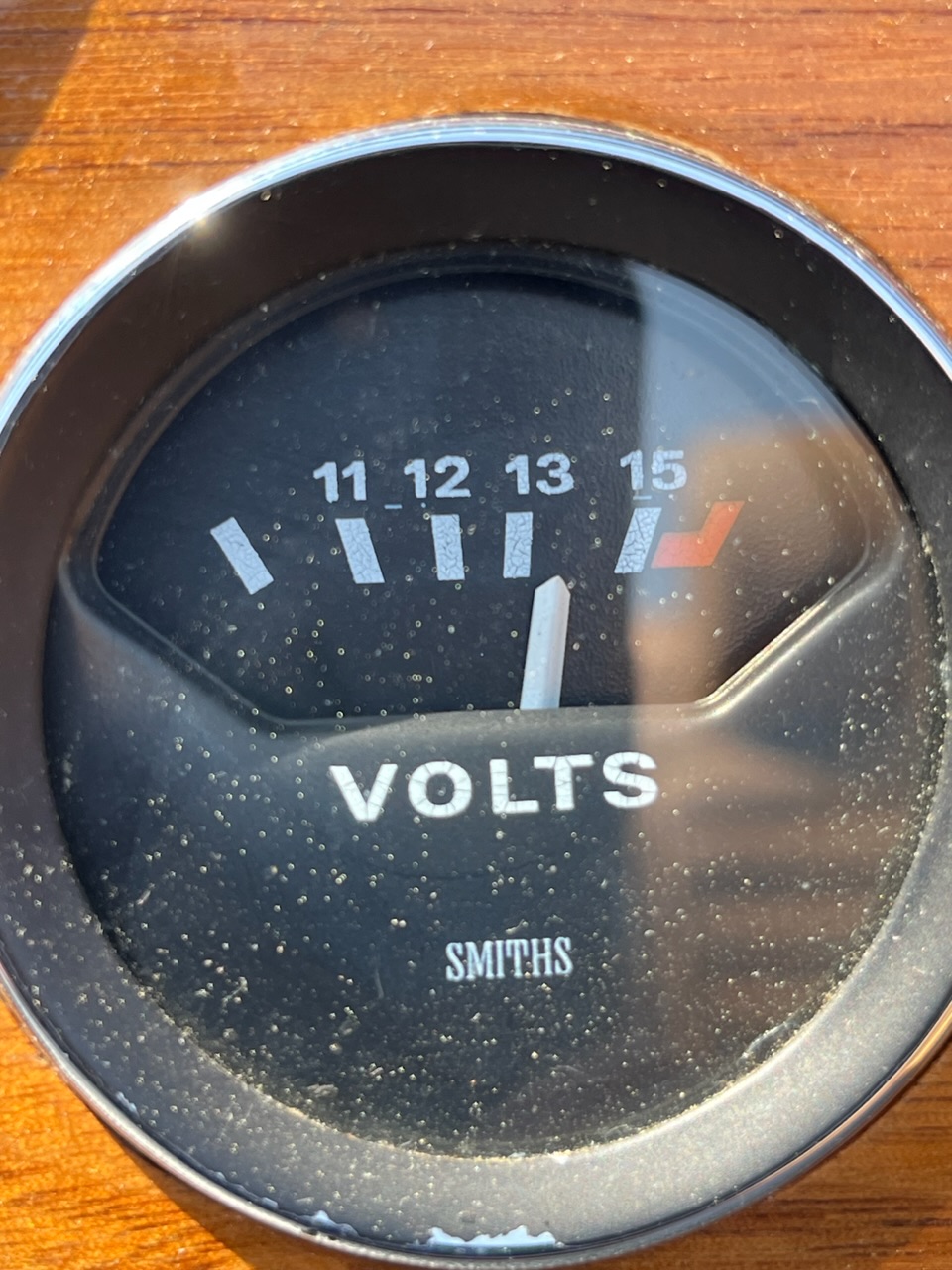

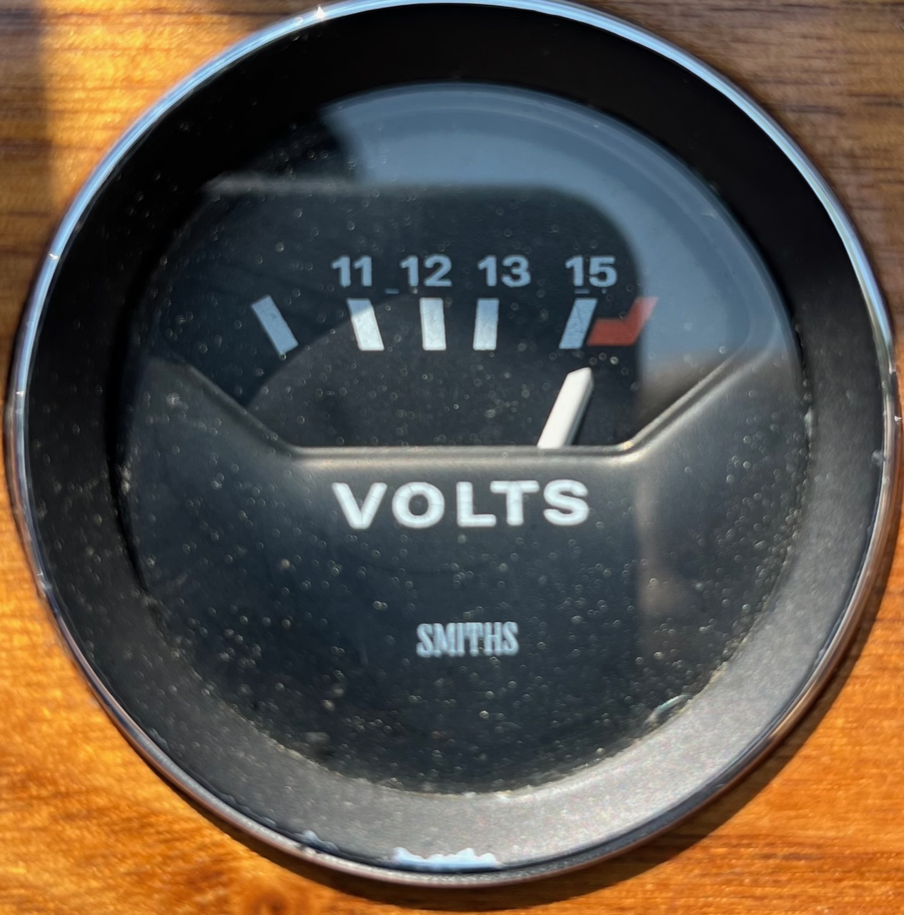

I started to notice that my volt gauge is pegging full at 15+ volts. It will remain there for a min or two then return to the normal charging range of approx 14 volts. Engine rpm has no effect on gauge.
What’s going on?

Thanks again. The battery (Deka) is relatively new; about two years old. I’m just returned from a 4-5 mile ride and the gauge stayed at 13.5v. Will do more investigating tomorrow.
Did some checking:
Engine off= 12.8 v
Engine on= 14.1 v
Ground strap and battery terminal are good too. All seems perfect to me. Going to check the ground on the volt meter tomorrow then do a load test on battery.

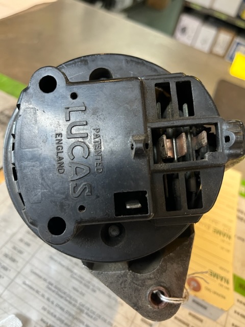

Update.... took the car out to get the battery load tested at my favorite local alternator shop only this time I had my Fluke meter with me. About halfway to the alternator shop sure enough the volt gauge was pegged at 15+ so I stopped and put the meter on the battery..... Alternator was putting out 16.8 volts! I continued on to the shop and the volts dropped back to 14.1v.
The guy at the alternator shop (who owns a brit car) thinks there could be a slip ring going to ground intermittently causing the fluctuations in the output voltage. He thinks he has the same alternator on the shelf but without the connector for the volt gauge so he will just move mine over to the new one. As far as I know, the alternator in my car is the original and I have never had it rebuilt.
On the drive back home once again the volts spiked high so I just stopped and unplugged the alternator so I wouldn't cook the battery.
Going out shortly to remove the alternator.

My alternator was completely rebuilt and I got it back yesterday. This afternoon I installed it and took it for a brief ride. Volt gauge was steady at +14.2 volts for the entire time so it appears all is well!
