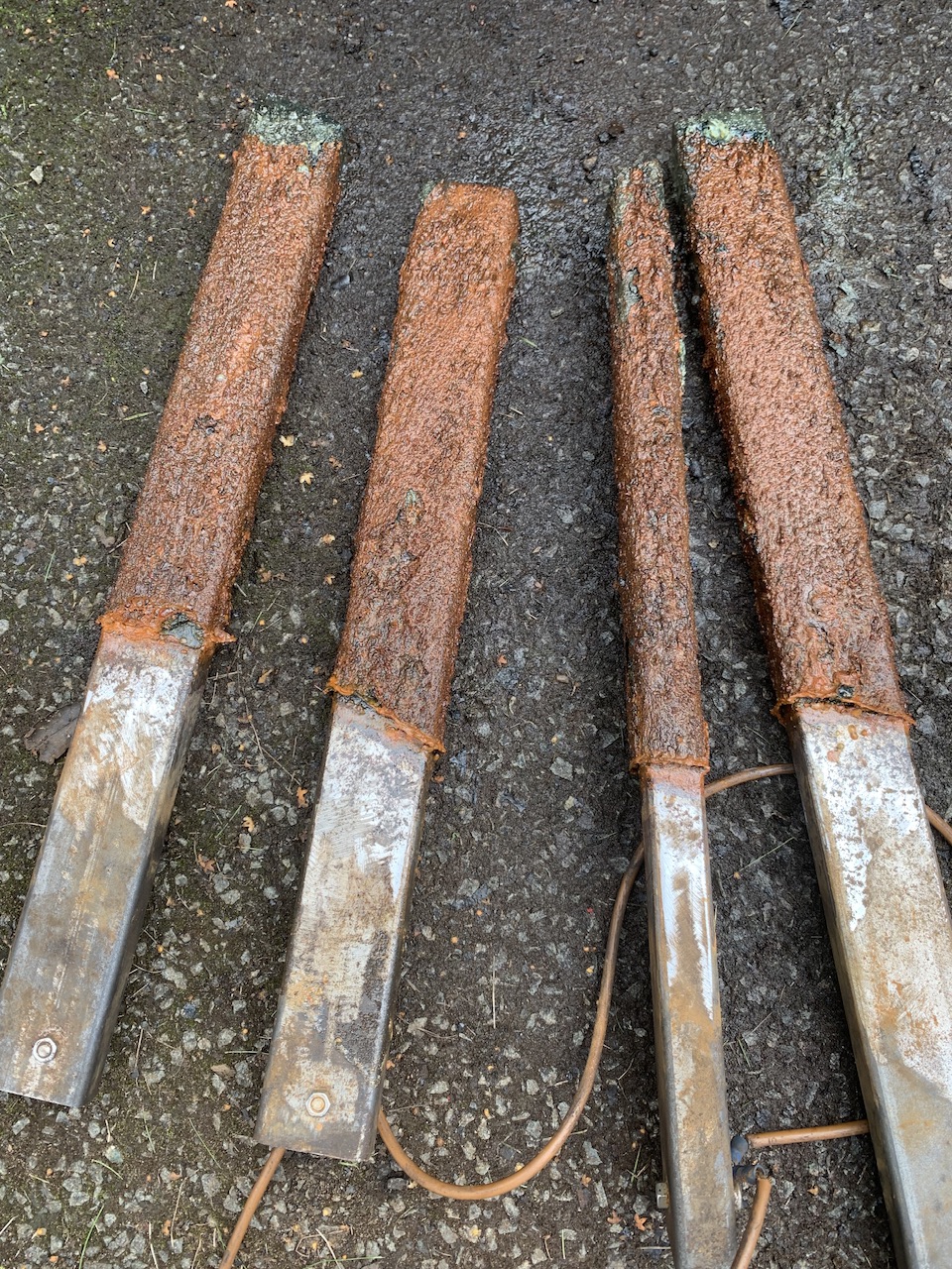

i use a batery charger and a bucket of arm and hammer washing soda,
put sacrificial rebar in the corners of the tub connect them together put positive connector on the rebar
and negative on the part you want to derust. switch on the charger, and watch it sizzle for a couple of hours,
all the rust will transfer to the rebar, will not effect any good metal in any way.
then a quick wire brush and rinse off.
