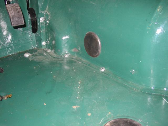

On a TR3A that I restored, I cut a hole in side of the the tunnel and access the fill plug that way. The rubber plug that fills this large hole is the same as used for the jack holes in the floor pans.

A hole can be drilled and plugged in the TR6 exactly the same as Don shows for the TR3. When checking the oil from below, a paper clip bent to a 90 degree angle with the end wrapped with good sticky masking tape can be inserted then read to show the oil level -- just make sure the tape is well secured to the clip!

I now have a hole in the tunnel similar to what Don shows (though smaller and using the tunnel plug from a TR3-4) and that is really the easiest method of all.
